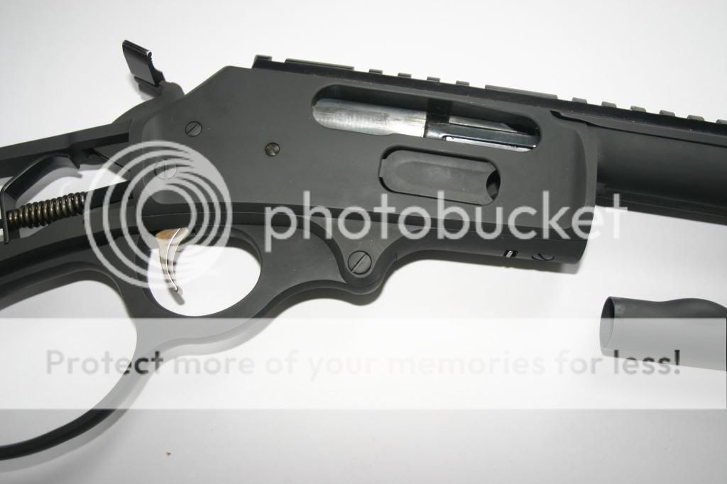

I got my Marlin back from Valcun today looks good to me,less than 2 weeks turn around,I missed sending 1 screw to be done.We will see how it handles the salt water coast up here.
