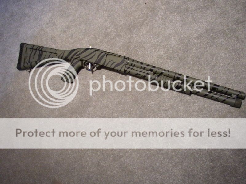

I don't know if bead/sand blasting would have been better, but we used 400 grit sandpaper on my Defender. All you really need to do is rough it up a bit so the paint/enamel adheres. We did two coats using an airbrush and stencils.
The barrel and receiver had some pretty deep scratches prior to paint, but the two coats filled them up. You can't even notice them anymore, even with close inspection.

Anglinfool, very nice job on the shotty. Im curious how much armacoat product you needed to coat it twice. If my slide turns out as good in stainless as yours did in camo pattern, ill be very happy. Did you cure the finish in the oven for 30 minutes as they recommend or wait out the 29 days at room temperature? ( im thinking you would have needed a big oven:redface: ). Also, how is the end result? does the coating feel good and resistant? The thought of also buying their clear coat to add even another layer of protection had crossed my mind but they say their product is very tough and wont scratch, fade or wear off easily over time.
