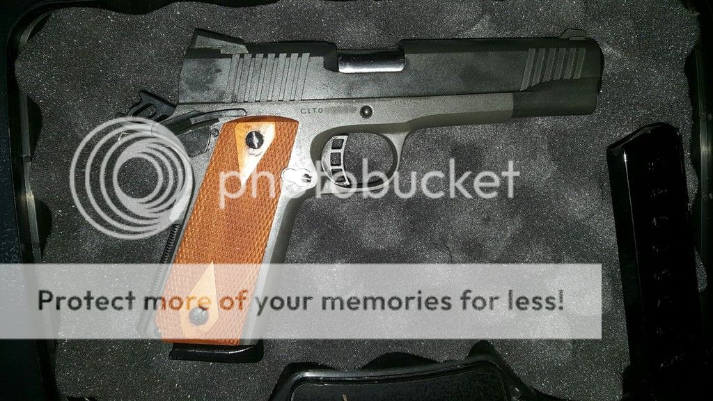

Here is what was delivered:

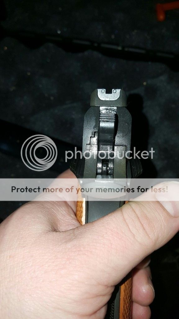

Slide, beaver tail, and hammer fit is good
The brand Citadel is lightly etched onto the slide
Minimal markings on the other side
