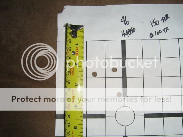

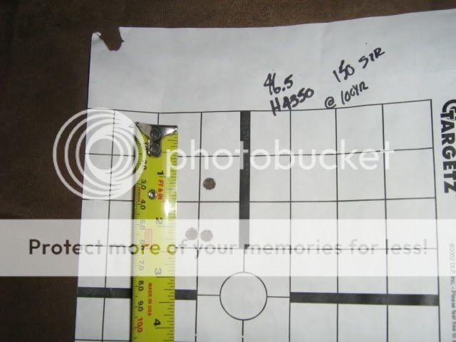

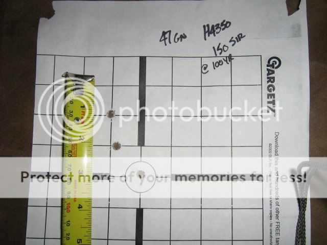

OK, we all know what assuming does!:) Went to the range last weekend to work some 150grn loads for my 7-08, started @ min worked up to max, will almost. Min load was 45grn of H4350, Max 48.5c of H4350. Only went to 47grn. Anyways, as I shot each(3 round) set, cooling between, this is what I found(excluding 45 & 45.5grn) Groups seemed to get tighter between 46 & 46.5grn:
46grn 3 shot group:
46.5grn:
47grn:
So with the given results, 2 questions:
1- Should I "Assume" best results are between 46 & 46.5?
2- If so, how much will a .2grn powder charge affect the load at this point?
Any and all in put will be greatly appreciated!

I would try the 46.5 and play with seating depth. That looks like it wants to be a load assuming the two almost touching were the first two.
The other way to find the sweet spot os with a chronograph. You will often find that a load of powder will tighten the spreads in velocity. When i find that I then adjust seating depth by .005 increments to see if a great load comes out of it.
If you shooting 3 rounds per load I'd shoot the same ones again and add in 47.5 and 48 if the pressure is ok. I always like to see the group repeated before I focus in on fine tuning but also try multiple distances off the lands as well with new bullets.
If the round is to be fed from a magazine, very often you don't have much latitude to mess with the seating depth. What is the rifle for? If it's a big game rifle, then 1.5 MOA is certainly going to get the job done, and you'd be hard pressed to shoot more accurately in the field. You don't shoot groups at game anyway. If it was me, I'd go with the 46.5 gr load and shoot it at ranges out to 300 to confirm the drop, to see if the 1.5 MOA holds up at long range, and see how the bullet behaves in the wind. If it doesn't meet my expectations I would change to another bullet.
You might see some minor improvement by splitting to a quarter grain, but you are getting close to where the limitations of the powder scale, and weight variations of the bullet and cartridge case over shadow any potential benefit. In any case, dropping or adding a quarter grain will not take a 1.5 MOA load and make it a .75 MOA load. I wouldn't bother, but if you want to experiment go ahead. Anything we try adds to our learning curve.
If the load is for a hunting rifle, power trumps accuracy (within limits), and reliability trumps both. If you stumble onto a load that plants the first cold barrel shot precisely to the same point time after time, that's the load I want, even if it's a 3 MOA load.
Before you do anything make sure the barrel is free floating. try working up the podwer more. when working with seating depth seat to the lands. some barrels like a jump but seating a bullet to the lands should be the most accurate.
