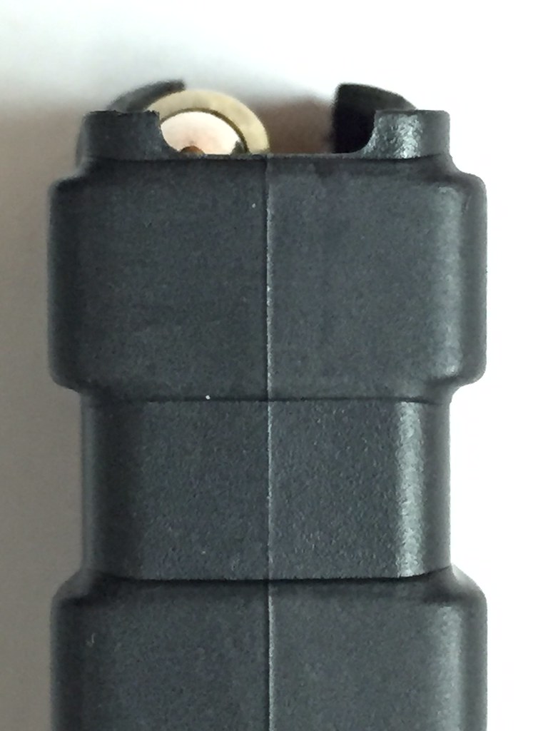

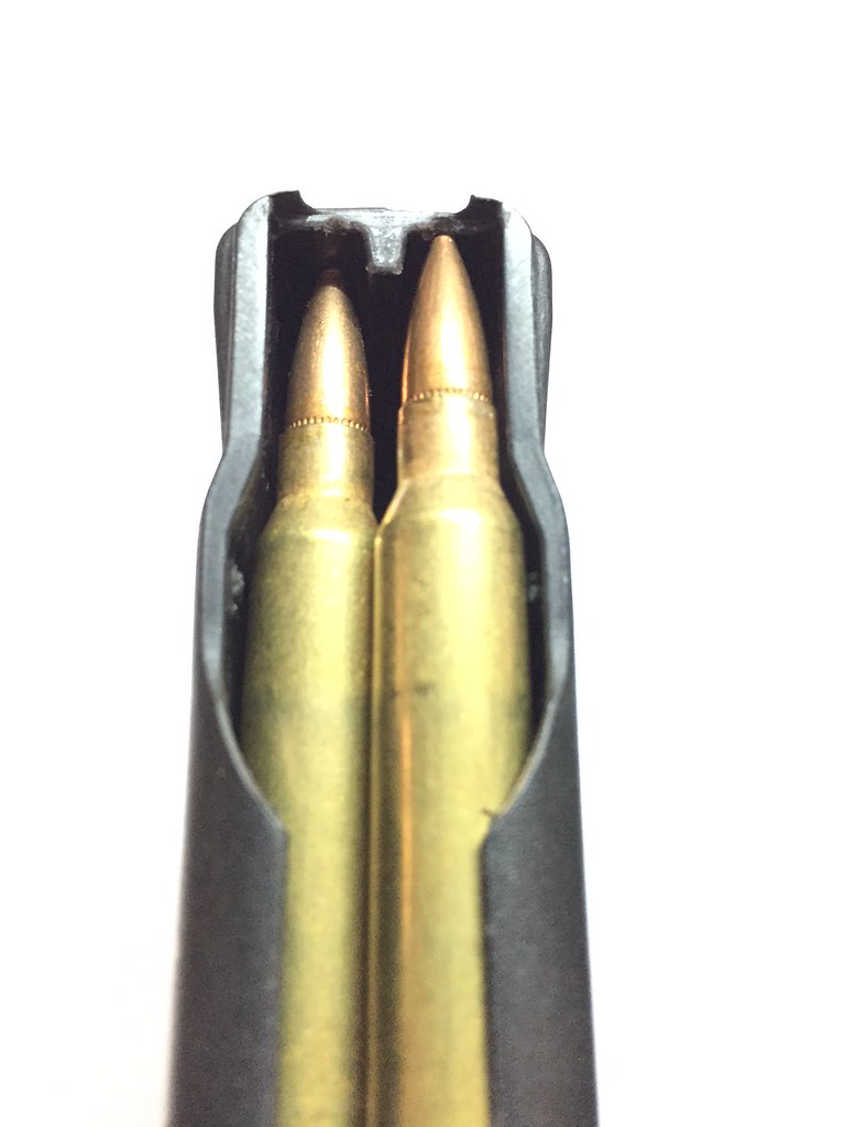

Here's the problem with one of my three mags. The tip of the ammo sits just below the top of the lip. Second pic shows where they are starting to gouge the lip of the mag. I would put a file to the lip and remove about 1/16" but I don't want to void my warranty.

Noticed rounds were sitting slightly low in six of ten magazines, but I found the problem was just enough excess flashing on the front edge to impede stripping the cartridge. Twenty seconds with a pocket knife fixed the problem.
They worked flawlessly in both my AR and Tavor after trimming.
Don't go full on crazy, but if you take a rat tail file and remove a little bit of the front wall you should be fine.
Worst case you are still covered.

I did work on lowering the lip on that one mag and it did help considerably but there are still some feeding issues with one of my rifles. I lowered the lip approx 1.6mm which was the point where I stopped seeing impact markings on the mag. The stock lip was approx 2.3mm below the top of the mag.
Seems that the mag sits lower in my Noveske receiver and just enough so that the tip of the bullet would run into the area directly below the feed ramp of the upper receiver. On an open bolt on my Noveske rifle, the problem occurs roughly 30% of the time. On a closed bolt, the problem is 80%. Seems the follower is a little slow lifting up the front part after it is pressed down from the closed bolt or changes the orientation of the mag. There is a bit of back and forth play with the mag in the magwell. If I push the bottom of the mag towards the muzzle, it would raise the front of the mag enough so that the ammo would cycle 100% of the time. Conversely, if I pull back on the mag, it is almost guaranteed to fail. This Noveske lower has worked 100% with LAR15 mags, XCR Pistol mags, AA 50Beowulf poly mags, PCV Gen1 and Gen2 mags and Magpul PMags.
The mag seats fine in my DD and Rainier lowers so that the tip of the bullet catches the feed ramp and are able to cycle on an open and closed bolt with 100% reliability.
Swapping the upper that is on the Noveske onto the DD and Rainier Arms lowers had a 100% function so that rules out the upper being out of spec. All three lowers have Norgon ambi mag release
It is possible that the Noveske lower has more play in the magwell compared to the DD and Rainier Arms and the looser fitted AT15 mag just compounds the problem placing everything out of spec for problem free feeding.
