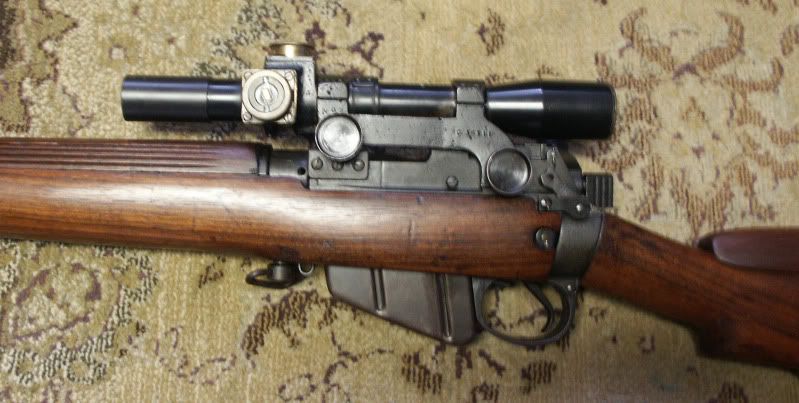

Here's a pic for the No4Mk1, your receiver would have more than two holes drilled and tapped.

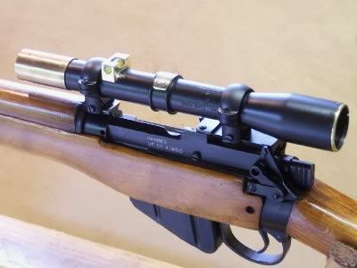

Here's a pic for the No4Mk2, your knox form would be tapped.

Au contraire...with the B Square mount I had I was able to use a Mk II rear flip sight. And you could see under the scope mount and use the sights. But the mount rail is out of spec, Picatinny rings wouldn't tighten properly on it, depending on the type. It's also very thin, flimsy aluminum, weighs like a couple of ounces. That's not to say it's not good but...

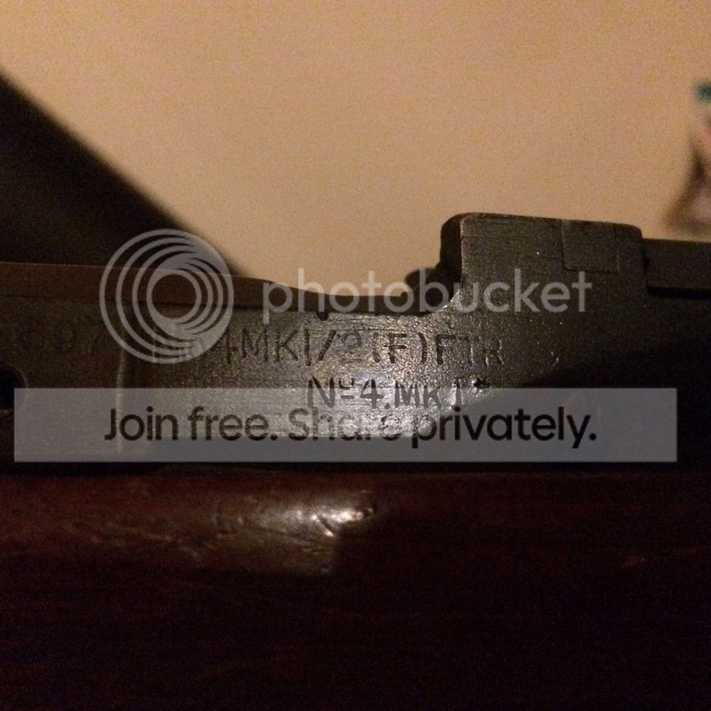

Your rifle is actually a No4Mk1/2, (No4Mk1*) not a No4Mk2. (and a nice one:))
I'm uncertain as to what type of mount your receiver was drilled and tapped for, but I am certain that it is an after civilian market type mount. Not milsurp as per my pic.
well just to be extra picky it is a No4 Mk1/3 :)

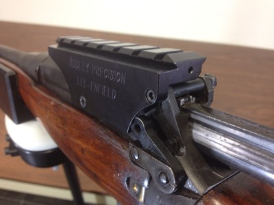

Here is the Addley Precision mount, I have one on my Lee Enfield and find it is the best of all the No.4 scope mounts on the market, and real solid. It also has a built in back up peep sight.
He's made generation after generation. Mine accepts a Mk II flip sight, just like you see in the pics of the B Square. Yours has the hole in it.
He even has a specific mount for Long Branch rifles now!
