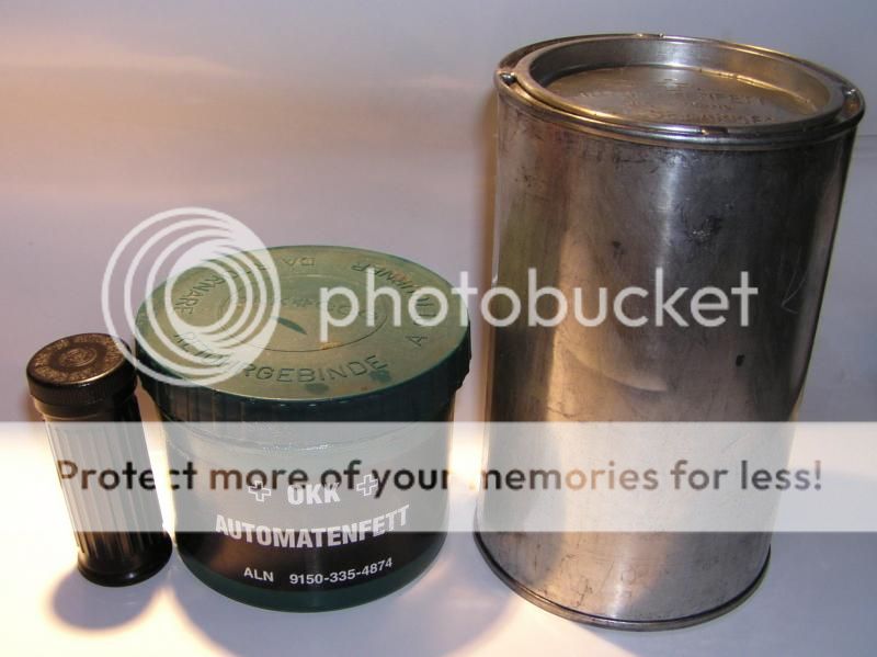

I have a K31 and its cleaning kit which contains two containers of automattenfett (grease). How does one use this properly? My K31 has a great bore, no doubt due to the use of this stuff, and I want to keep it that way.

The grease is used for three purposes being cleaning, lubricating and protecting and the last can be divided in normal use and storage.
To start with the cleaning first, before shooting the Swiss run a pad through the bore to clean out the grease there and from the bolt face, they do that with the help of a grease rod, that ones comes with a jag for a pad and a black grease brush.
Immediately after shooting they run that black brush with Automatenfett through the still hot bore, put some grease on the bolt face and leave it like that. After they get home they clean it all from the grease, get a bore rope or cleaning brush through the bore and after that they lube it all again with fresh grease that stays on till the next shooting match.
The grease dissolves the fouling and makes cleaning way more easy as using oil.
Lubricating during normal use is only done on few spots, the most important ones are the flat (or round with the older straight pulls) inside receiver sliding part of the operating rod and the tip of the operating rod where it enters the bolt sleeve groove, that area needs to be lubed well.
There should be no grease inside the bolt or at the outside but it won't hurt to use a tiny bit in the locking nut area.
Do not use too much grease, the manual reads for the K31 "battle lubricating"......NONE , so the above is only to make your rifle operate more smoothly with less wear, after all the shooting range is no battle field.
The protecting part is easy, Automatenfett can be used on bare metal to protect it against corrosion, use it limited especially on moving parts as we don't want sand to stick to these.
For storage, the -"Parkdienstschmierung" as they say there- it's easy also;
Barrel inside and outside, greased
Chamber, greased
Trigger assembly, inside bolt and hammer piece, NO grease (still the arsenals did not follow that rule that well as examples show)
Bare metal parts, greased
Blued parts, greased
The storage part is the reason why so many new owners of K31's in the USA think that they are in Cosmoline which is not the case, when they have been in storage in Swiss arsenals for a long time they are still well protected by the old yellow Waffenfett, the more recent ones are well protected by black Automatenfett.

Automatenfett was DESIGNED for semi-auto and fully automatic firearms - the black stuff in it is molybdenum disulphide. The earlier waffenfett is like most other high quality light greases that are animal-derived, rather than hydrocarbon. I've been using it and similar stuff on my Swiss guns since 1989, and they are in no way any different down the bore from the day I bought them, as a result of using the same régime as that posted by Latigo. BTW, he probably has around a hundred or more of them...

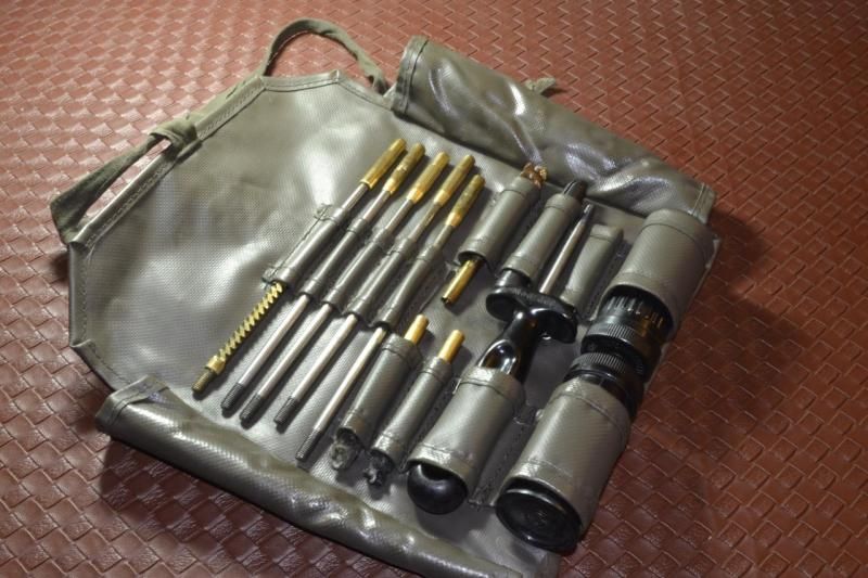

As to how the Swiss Grease their bores:
Nylon bristle bore brush dipped into can of grease.
Idea is to coat chamber and bore with a light layer of grease, not to plug it up, but seal it off from air for rust and tarnish prevention.
Also prevents the carbon from hardening up and causing a dark bore. Need 3 or 4 passes with 90° turn per pass to evenly coat bore.
Grease does not dry up nearly as quickly or run down with gravity and pool like oil does.
The Swiss rod attachment pictured above allows the nylon brush or a brass brush to be screwed into the tip of a brass jag used for patches.
Patch is rolled diagonally over the jag and is used to push out the grease before firing
There have been cases of people forgetting to clean off the grease which raises a cheer from the assembled Swiss shooters since they all get a beer paid by Herr. Forgetfull. No harm is done to the rifle and this occurrence is called a "Fettschuss", greaseshot.
The ones piece Swiss rifle rods are not easy to find here buy the Stgw57 segmented rods kits are.
Threading is metric, so U.S. and Imperial attachments are not interchangeable.
