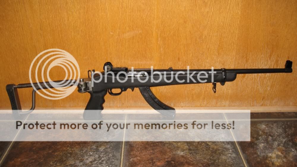

i recently set up 2 10/22's with B.C. folder's, and both have issue's with the trigger group pin creeping too one side so that the trigger bind's and you have a single shot with 12lbs trigger, not alot of fun in the bush if it happen's every 25-50 round's,so to fix this i can use J.B. weld , nail polish or lock tight right?anyone else have this prob?:bangHead:

yea whamo it's the same stock,for some reason the pin holding the trigger&sear has enough room to creep to one side till the other side fall's out of the housing ,thus the trigger can pull sideways and bind.it's annoying when you have to field strip every 50 round's.

Are you sure you have the correct pin in that position?? :eek:
Very strange....:confused:
If they are the correct pin(s), Lone-Wolf if right...a piece of duct tape should do the trick.
Are these old or fairly new trigger housings/pins?
Aluminum or polymer?

I have the same stock and had the same problem. A piece of tape as a guide, and JB weld to fill the gap on the stock where the pin protrudes is good medicine.
I'm around 10 000 rounds and counting after this fix...
