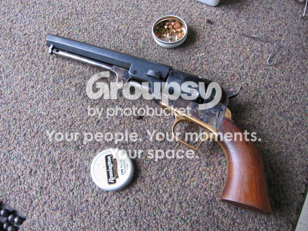

Here is a picture of my Baby Dragoon with Remington #11 caps,as mentioned if the caps are a bit too big you can pinch them into an oval shape and they will stick on the nipples.
