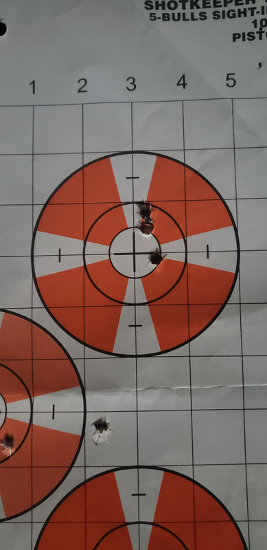

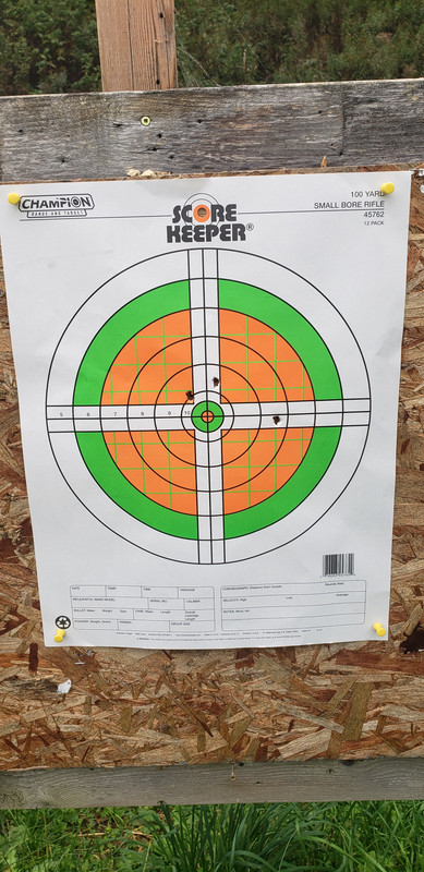

Going moose hunting next week, so am loading up some 150gr TSX's for my .270. After a lot of reading, I should probably have just stuck with 130gr, but the salesman at Epps convinced me otherwise. Well, stuck with them now, if they don't make good groups tomorrow, will have to likely treck back there and get the 130's, money is tight or would have just bought both.
