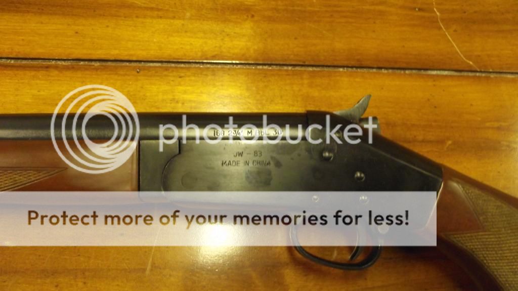

Hi TripleF
Here is a picture of my JW-83 16 ga 30" barrel.

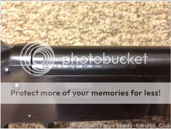

This is a picture of the JW87 28" bbl off the net.

ZhongZhou's model numbers are confusing but I think these are correct.
Hi TripleF
I stand corrected. Thanks for the correction. I did not realize that there was a 16 GA JW-83; always thought that the manual was referring to the Gauge-dependency purely on the model, where I thought the JW-83 was the Backpacker in 12GA, only. Now I see there is a JW-83 16 GA non-Backpacker and JW-87 12GA.:runaway:
