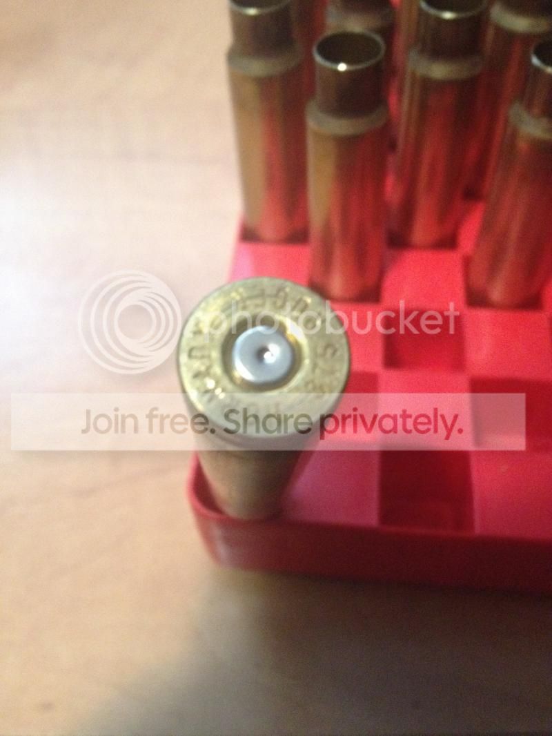

Ok so I have had some issues with Failure to Fire.
now at 3 In my 375Ruger
had one in my 243win.
the one in my 243win are CCI BR2. I re-chambered and it fired. Fluke?
The 375ruger is using CCI 250M primers
I am not sure if its a fireing pin issue.
somthing i have done wrong?
bad primers?
All primers from the same box (CCI250M). 3 "duds" over aprox 400 rounds fired.
I am using the same CCI 250M in my 30-06 trouble free
Primer pockets are all the same depth.
could I be seating the primer too hard?
what do you think

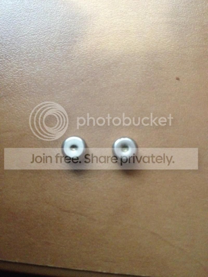

It looks like You have Good firing pin strikes. I would make sure they are completely seated. I would also maybe try different primers some guns don't like certain primers. Also how are You handling your primers I have been told and read that oil from your fingers in the primer can cause this also but it has never happened to me. I am very careful handling them. My guess is it isn't that I would try different primers first.
Buy the look of those strikes on the two primers you displayed I would get new primers. they were hit hard enough . one of my best friends has some CCI large pistol primers and I know these are rifle primers but he is now useing them else where due to the fact they are'nt working properly . I read somewhere Ganderite said Winchester primers are the hottest .
I know or should I say I have head Federal primers Detonate the easiest. did you clean the primer pockets ?? but I'll bet you a beer even if you did clean the primer pockets you will still have problems. CCI makes Milspec primers also but as I said with the way they were hit by your fireing pin they should have gone off . put them aside for target shooting - don't bet your life on them . JMO
