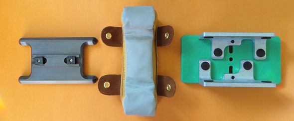

If your Anschutz rifle has an accessory rail, it's possible to buy or make a front rest bag rider.
Front bags for BR shooting are typically 3" wide. There are several options available from retailers, including the Whidden referred to above.
Below on the left is an adapter that attaches to the accessory rail. This one is available at Brownells (Sinclair). On the right is an adapter for a rifle stock fore end that doesn't have an accessory rail also available at Brownells. Between them is an example of a 3" wide front rest bag.

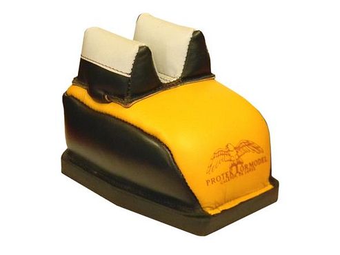

For the rear bag, get one that is heavy and has a solid base as shown in the example below. Rear bags like this one can be ordered from Protektor in the U.S. There are many choices and other manufacturers.
