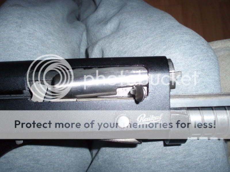

I received my Baikal MP-153 in the mail today, when I opened the box I found that the bolt was far past where it would normally rest in the receiver. It's actually stuck so far forward that the bolt has partially left the receiver body. I tried gently hitting the cocking knob to move the assembly back, as well as hitting the bolt face, (don't worry, I used a soft wooden dowel and a hammer) but no success.
I don't want to ruin it, has anyone else experienced this before? Perhaps it's an easy fix but I'm a shotgun newbie...

The bolt is jammed against the top of the receiver where the barrel would normally slide in so that's a no-go, thanks for the response though!
Pull the cocking lever out and let the bolt come right out. The n reassemble properly.
How do I get the cocking knob to come out? I can't find a manual online and I didn't get anything like it with the shotgun. Should it just pull right out? If so that's jammed in too...

Grab the bolt handle and pull it out with all your force (it is hard). When it comes out the whole bolt assembly will just come out and you will be able to reassembkle everything properly.

That did the trick! I had to use a screwdriver to force the bolt knob out, it took a lot more pressure then I thought it would. Thanks for your help guys, I'll be out shooting it next week!
