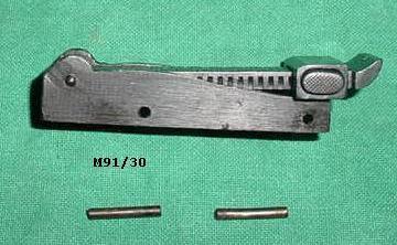

It doesn't have a dovetail for a scope, it was bubba drilled and tapped with some cheap bases screwed on. Also, i notice the only thing different than a 91/30 rear sight seems to be the little notch like cutout on the front of the base. And it's not that different :) look:
91/30 rear sight
toz 8m rear sight.

I'll try the pallet strapping idea. I know 100% that this sight is a lot longer than an sks sight, and the spring fits in differently. On the sks, the pin is very small, and there re little nubs on the leaf that the pin goes through (at lest on mine). I've read that they started production in 1934, so it would make sense to me that they might use the same sights as their current rifle on their training rifle. The only difference i can see is the graduations on mine are graduated in 25 metre increments from 25 to 250.
