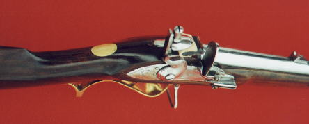

I'm interested in buying a reproduction Baker Flintlock Rifle in the future with actually a rifled barrel. Where can I buy an assembled one?
You could always get the real thing - IMA-USA has real Bakers ;) As for a repro, I think Pedersolli makes one - contact Marstar for a special order.
Well, if money is no object ... you could order a hand-built one from Peter Dyson & Son in England - though I suspect you won't want to pay quite as much as their £2500 starting price (C$5000) - especially since you could likely find a shootable original for that much! ... :rolleyes:
I think that IMA only has Brunswick-pattern percussion rifles, and I don't see a Baker rifle in the Pedersoli line. I'm not sure anyone is actually producing a rifled reproduction Baker for the market (except perhaps custom gunmakers.)
Although you may already be aware of them, there are at least two Canadian sources for the relatively low-cost smoothbore version of the Baker - for which "rifling options" do exist -
Discriminating General - Baker
This .62 cal. (as opposed to .69 - .70, which I understand was the other "standard" bore size of originals) smoothbore repro is supposedly made by the company which made the repros for the Sharpe's series - and they claim that Bernard Cromwell, the author of the Sharpe novels, bought his rifle from them. Nice looking, judging from the pictures. You will note that if you buy from them, they will put you in touch with a US-based gunmaker who will make, fit and install a rifled barrel (for US$150, plus shipping.) I take it from this that you'd still have the smoothbore barrel as well (which comes with the vent hole not drilled - though that is easily enough remedied, of course.) Their current price is C$679, and they also offer a repro sword bayonet and scabbard (apparently only available if you buy a "rifle") at C$140 .... I have dealt with these people for some stuff in the past (though not firearms) and have no complaints.

BTW: Does the seller provide instructions on flash hole size? I know the barrel is dimpled over the flashpan to locate the hole, but what about size? I phoned 2 gunsmiths jsut to see if a "qualified gunsmith" as referred to on their site would know what size hole to use. Neither of them had any idea as all flinters they see are pre-drilled. ???
Nothing magic about flashhole size. 1/16 is about the smallest practical, ignition time will be slower than 5/64 or 3/32. Don't go bigger, unless you enjoy a large eruption just in front of your face. Even then, ALWAYS wear eye protection! Probably best is to install a counterbored flashhole liner. Gets the charge closer to the flash of the priming, yet permits a small diameter hole. Apart from touchhole geometry, the lock really affects ignition time. The 7" locks on most muskets have large heavy moving parts with long striking arcs. Slower lock time, with a perceptable flash-band effect. Before drilling one of these repros, it would be a really good idea to pull the plug and inspect its fit, and the barrel very carefully. A flintlock smoothbore generates surprisingly low pressure, but better to be safe than sorry.
Trial Bakers were 69 cal but the troops hated the recoil. The Rifle Shoppe, were your photo is from, has rifled Baker kits, ($1075US) but they are slow to deliver. A fellow I know had trouble with The Discriminating General Baker rifle, he had to remove the breech plug because the flash channel in the plug wasn't complete and yes this is not the exterior touch hole. The flash channel didn't reach the face of the plug. I would put money on the $700 Loyalist model. Blair at Loyalist said that they would make a custom Baker using TRS parts for about $2500, but you would wait about 6 months. A rifled barrel is available from Track of the Wolf, so I guess you could buy the barrel with breech plug and barrel key and make it fit an Indian Baker. The Rifle Shoppe also sells the rifleman's tools and powder horn parts. The Rifle shoppe web site is a pain to navigate, if you need help I have both The Rifle Shoppe and Track of the Wolf catalogues.
