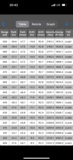

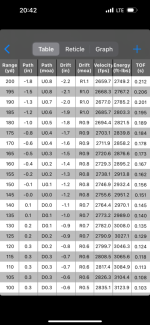

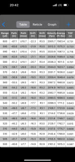

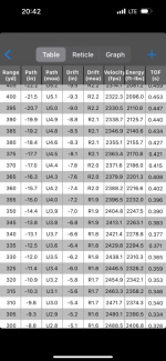

So I have worked up a sub MOA load for my 300wsm using a 175 grain LRX, 63.9 grains H4350, 24” barrel. I have a cheap Shooting Chrony that I have been using on every shot fired throughout development. This particular recipe is always around 3010 to 3040 FPS depending on the day. Yesterday it was around 3015 while I was shooting at different ranges to develop my dope card. I took my true bullet drop from 275, 375 and 500 yards and applied this to the Burris Ballistic calculator to get info for my Burris scope. Well when I trued in the velocity based on actual drop, it says I’m at 2957 FPS, or if I true it to BC it says I’m at .297. Using the .297 is giving me the most accurate (bang on) result when compared to actual drops on the Hornady Ballistic app.
Barnes advertises this bullet at 0.508 G1 BC. Has anyone else trued in the BC on these bullets and found they are way out?
