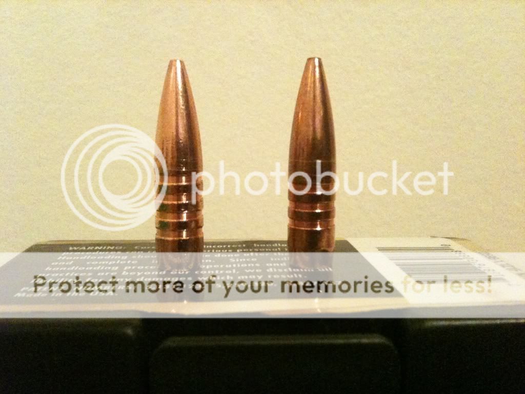

A picture of the 165 and 168 tsx
The boattail of the 168 is slightly longer, and using 0.302" as a reference line the nose is 0.025" longer. The 168 is the bullet with only 3 grooves. There really is not much difference, I have shot mixed groups of them with the same powder/case/primer and kept all the shots inside 1moa. I wouldn't worry too much about switching between the 165/168 for accuracy. I would try the ttsx though, I got some great results with them in my 338 and 300wsm.
