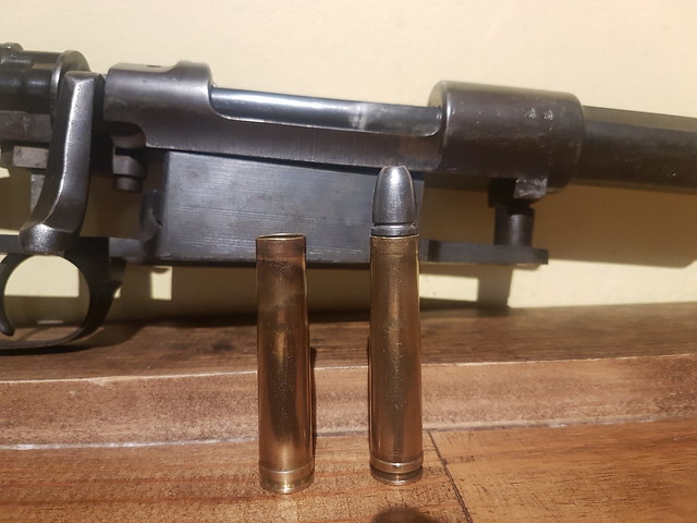

i chased the threads on a 71/84 Mauser barrel from 1.000" x 12tpi, down to .980" x 12tip and threaded it into one of those receivers, I set the head space with the belt but the barrel indexed properly.
i cut a belt groove in the camber and now use 375hh brass cut to 62mm and ran though 43 Mauser dies and call it for the 43 express
Nice work and great idea.
Keeping those old rifles working and sometimes even improving them is a great pastime. Especially with results such as those you have achieved.
With that action, and jacketed bullets, that would turn into a real mauler of a cartridge.
