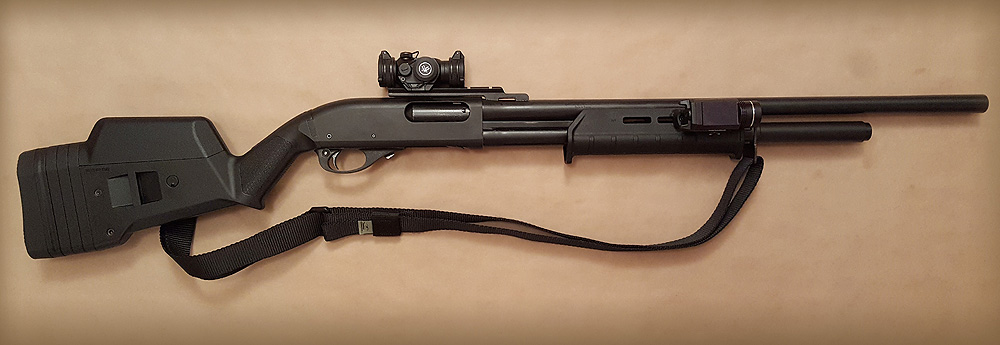

Here are examples of where the sighting system is fixed to the barrel .... both are 870 Police shotguns ....
