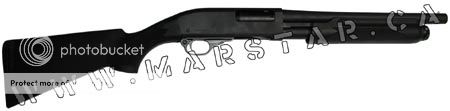

however companys can build them less then 18". like the 12" IGA backpacker. which is still non restricted since the total lengh is over 26".
Or the 14" Norinco shotty as sold by Marstar:
