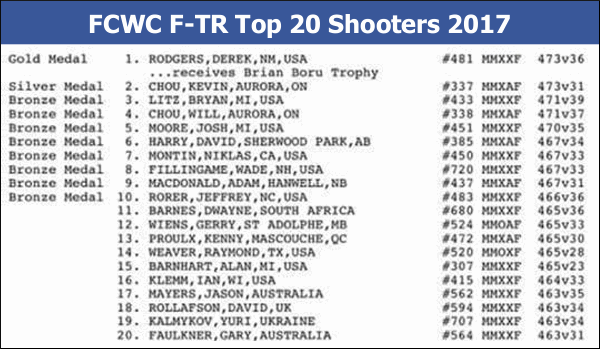

Scores from 2017 FCWC in Ottawa 1st 473-36 2nd 473-31...World Champion won on V count, not points. It is a fun but competitive sport; everyone wants to ring out every last point from their rifle system which typically means changing out barrels well before it practical life is over but where they have noticed an increase in vertical which is costing them points.
As an FYI the next chance to be world champion is in 3 years 2021.
