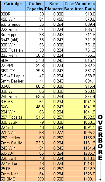

Keep in mind that most barrel life numbers assume you're running the cartridge near its maximum pressure. Running lower pressure loads can extent barrel life drastically. The opposite is also true.

Running them at maximum pressures and using hot burning powders. The worst thing you can do, even without high pressures or hot burning powders, is to shoot large volume strings. If your barrel is uncomfortable to the touch, you need to stop shooting and leave it cool down.

I've replaced several barrels and have one or two on order as we speak. Its my opinion that velocity is the highest contributing factor. Rifles that shoot velocities in excess of 3500 fps last fewer rounds than a rifle that shoots 3000fps. Rifles that shoot less than 3000fps I've never had to replace the barrels.

Its not velocity. Velocity is simply the result of pushing a huge amount of burning powder down a small bore. THAT is what damages the bore.
If it were possible to use compressed gas to produce large velocities without the heat, the bore would last much much longer.
