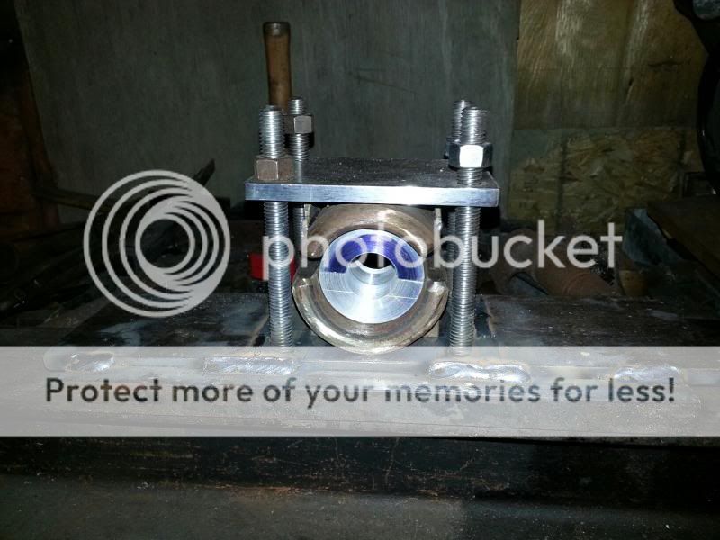

You can make one or have one made... this was made from 2 inch bar stock and faced to be 1.5 inches thick. The hole is 1.5 inches and I use steel bushings split in half to fit the barrels... lots of weight to it and bolted to a solid bench.
a pipe fitters vise with steel or aluminium inserts will work . you will want to use a small amount of rosin in the inserts.
I made a vise just recently ... some thick plate, the eye part of a big truck leaf spring that i split in two.. then made some jaws outa 1.5" aluminum round ...drilled then bored a hole on my sherline lathe
grips real good, but it took me awhile to get the aluminum off the barrel... left a lite alum marking that was on there like the devil... simple green took it off
I'm really diggin guntech's vise... man, thats a nice one !!

Dennis, for some reason your picture of the vise is not coming up.
Appreciate the input. Seems like the majority recommends making one. I don't have the materials or tools/machines to do that. For those using inserts, are you making them yourself?...I guess it wouldn't be hard if you have the materials and tools but I don't so it would buying a vise makes more sense for me anyway.
It's there for me...
try viewing this address: http://photoshare.shaw.ca/image/3/b/d/203599/barrelvise-0.jpg

I use one like guntech but made from 1.5" square. I mould epoxy bushing to fit with a mould not with the vice and I do not use Brownells system, far too difficult. After a few barrels are moulded I can usually find one that fits well enough so I don't mould every barrel that I touch. The odd barrel may take a bit of rosin if it slips but no barrel has beaten me yet. I tighten the two cap screws with a standard 1/2" ratchet, no need for three foot bars etc. If you get a job that you know will take a new bushing you need to allow a day to get it made.
