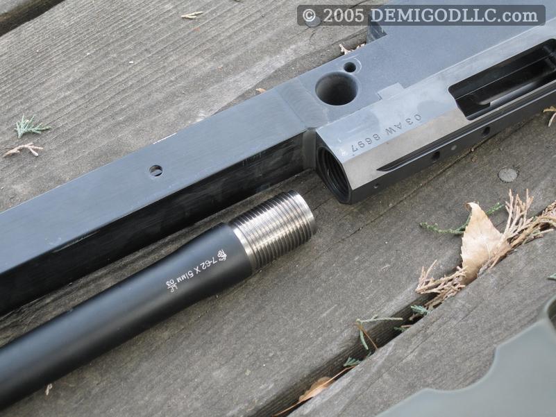

The barrel shank/threads on them is 1.5" long as opposed to 1" and they head space off a breaching ring so a bit different than most but not impossible.
GAP does custom AI barrels.
I explained to the Chou Bros how to chamber for an AI. Because the action is unitized to the chassis, you can't screw the action onto the barrel while it is in the lathe to check headspace and thread fit while chambering. You need to create a jig like this that allows you to measure the headspace off the shoulder:
Threads can be measured with wires.
Talk to the Chous, they were interested in doing it and may have already done some barrels for AIs.
