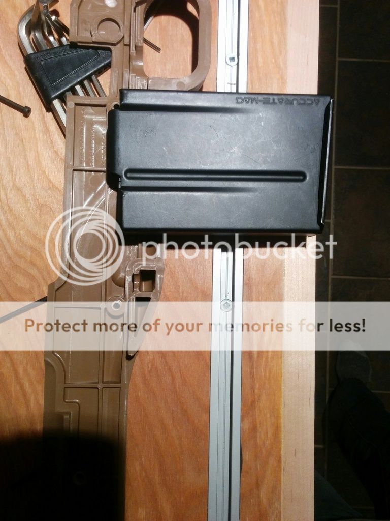

Sorry for the delay in posting those pictures.
As I noted, the problem I find is the rifle with most barrel lengths and contours, strikes a balance point slightly forward of the magazine well. Ideally you would like a flat spot there with a 90* wall to get the most stable position. Problem is, my AICS skins and these Victor company skins have a radius/ belly that makes the rifle act like a seasaw:

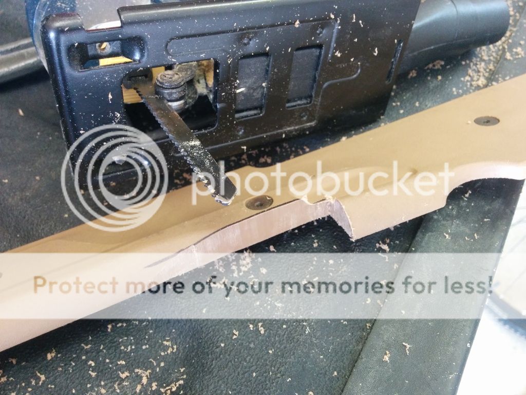

So after taking the skins off and examining the underlying metallic backbone of the chassis, I realized that belly could be removed without compromising any integrity for mounting and function. As you can see from above, there are some nice lines molded into the plastic skins on the inside to follow as a cutting guide. I started with a small handsaw and realized I wasn't patient enough. Turns out the jigsaw worked way faster and cleaner:

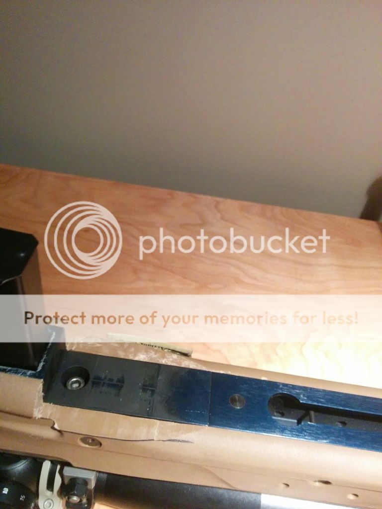

When cut correctly, you can see the mounting holes are left perfectly intact with plenty of material around them. The result was:
The cut closest to the foreground was with the jigsaw, the rougher one was with a handsaw. Both have been sanded smooth now and look cleaner. The result is a rifle that now natural settles into a steady, balanced position on various barricades. It can be loaded into the magwell now without riding up over the belly onto the mag (which for some may cause feeding issues). I'm a butcher I know, I don't care. Its plastic that can be replaced.
