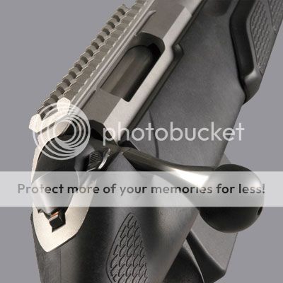

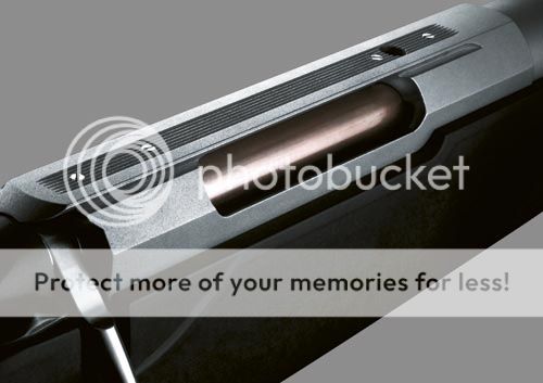

Ok - tikka is drilled and tapped like this
You can screw a pic. Rail on like this

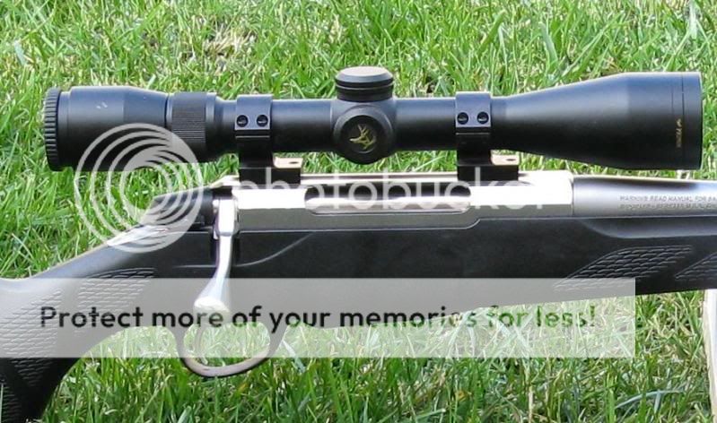

Then put pic. Rings on it like this

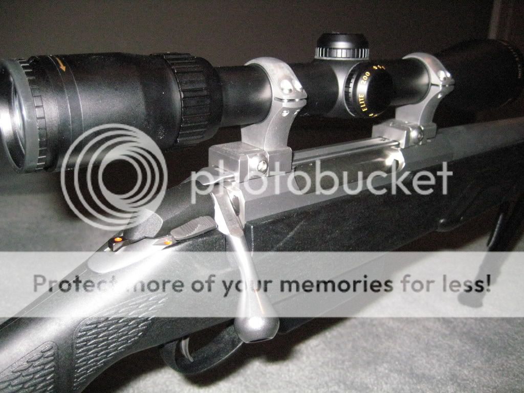

Here are the talley lightweights
Here are the optilocks over the dovetail
