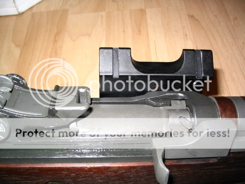

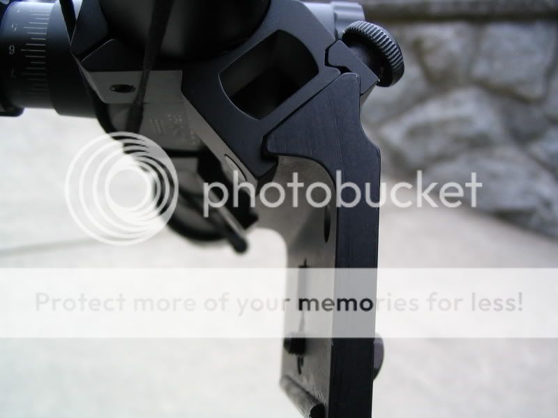

Now that I've had the chance to put about 400 rounds under this mount, I'd have to say it's a winner. The system is based on a single hardened bolt which threads into the M14 receiver. The ribs on the mount fit into the recesses on the receiver and that's it. No locktite. No need to take out the guide and you can still use the irons if the ocular isn't too big. The bolt in the mount has never shaken loose, which is quite incredible, considering the specified torque is 20in/lbs. This tightness is achieved by using the little wrench supplied and simply placing it on the bolt (after finger tightening it) and while holding onto the string, lift the rifle off the ground. It works! The mount is rock solid. I did an occasional check with the wrench just to see.The machining is so good that I was able to take the mount off the rifle I was using and had zeroed, then replace it without loosing zero. Next I took it off the same rifle and put it on a different one and the shift was only a few clicks from point of aim. The mount is an agle mount which seems to be about a 45 degree cant. The spent casings don't hit the scope and none were deflected by the mount itself.

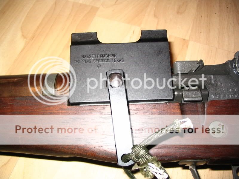

That's the torque wrench! Stand the rifle on its butt and lift up slowly on the string til the rifle is off the ground.... voila repeatable torque without jerking around

That's the torque wrench! Stand the rifle on its butt and lift up slowly on the string 'til the rifle is off the ground .... voila repeatable torque without jerking around.
A welfare torque wrench! Love it! Longer bars will give greater footpounds. Although longer bars on a Friday night lead to greater hangovers.

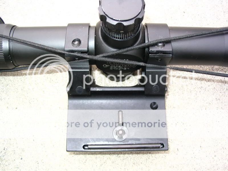

I used the same type yesterday. Never lost zero. Good little mount for sure. My only complaint was with scope relief. I couldn't get the scope far enough back for my liking but that may be more a scope issue than a mount issue.
Scope relief looks like it could be an issue on some scopes as there is not much for adjustment. That is the problem with a lot of the M14 mounts though. I had to get a riser rail for a scope I put on mine because the arms never came back far enough.

I would use the lowest rings I could find and still have the clearance for the ocular end. Taller rings only move the centre axis of the scope off line.The eye relief is a bit of a problem, but that isn't really the mounts fault. With my scope setup I can still see underneath the mount with the irons.But the best part is the ability to take the scope off the rifle and replace it to the same zero. I've even changed rifles and was pleased to see not a huge variation in zero - ie still on paper. It works good enough for the welfare sportsman. With the cost of ammo going thru the roof, we'll all be in the poor house soon
