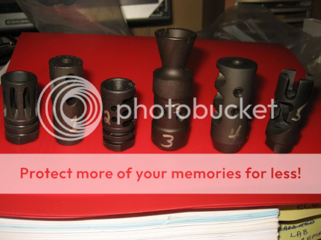

I have picked up 4 more brakes at about $25 each.

Not sure what all the different brakes are in your picture, but my money is on #4.

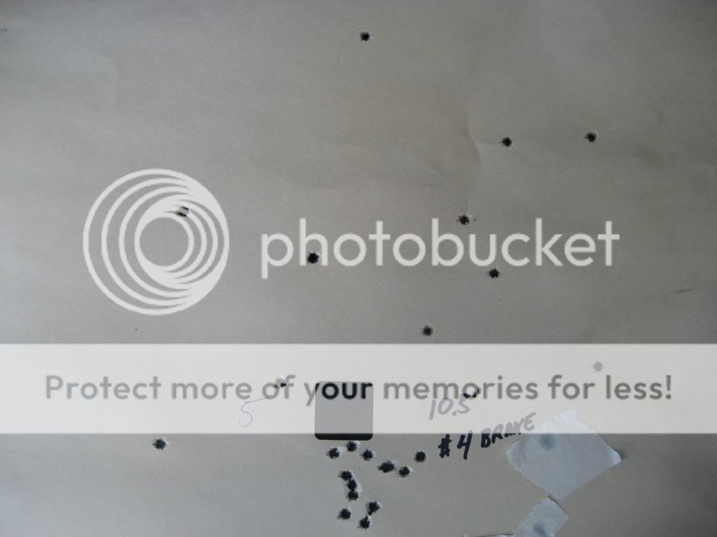

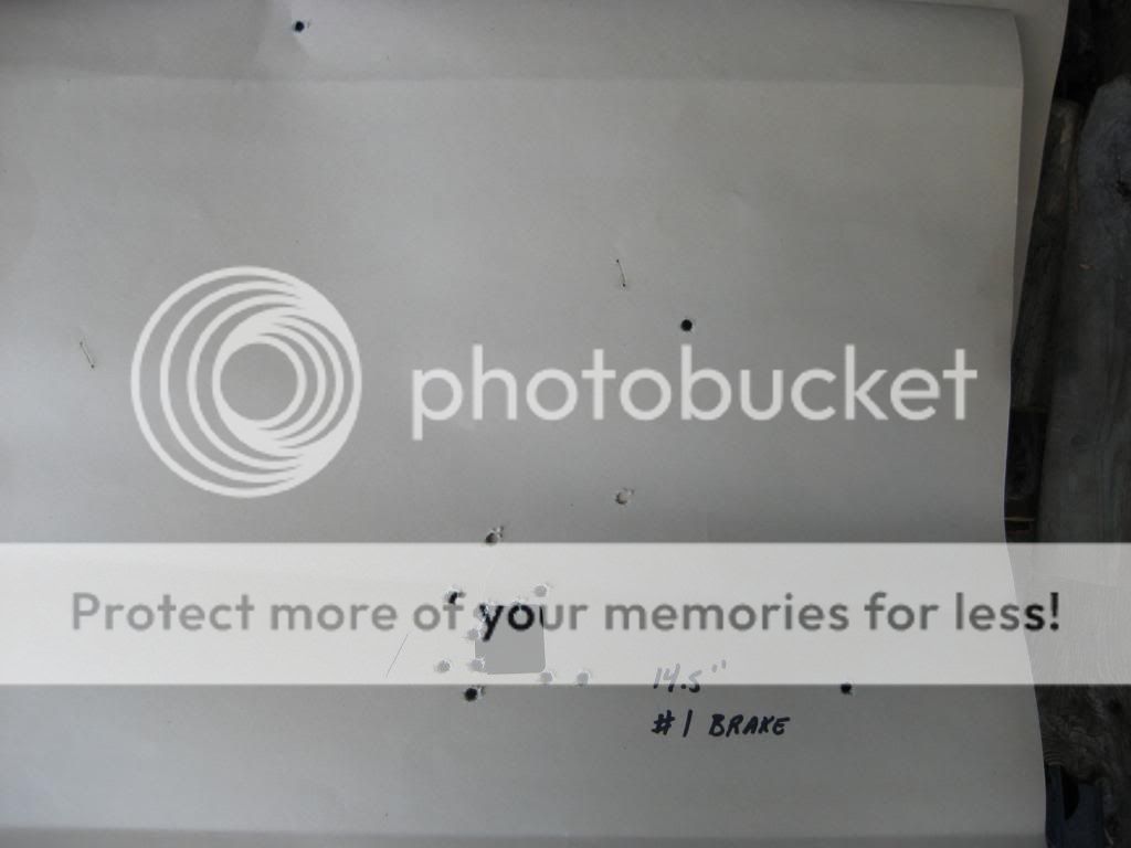

OK. Shot the test.
I started with what I thought would be the most appropriate of my brakes for each length rifle. The 14.5" worked ok, the other two were poor.
This was ok.

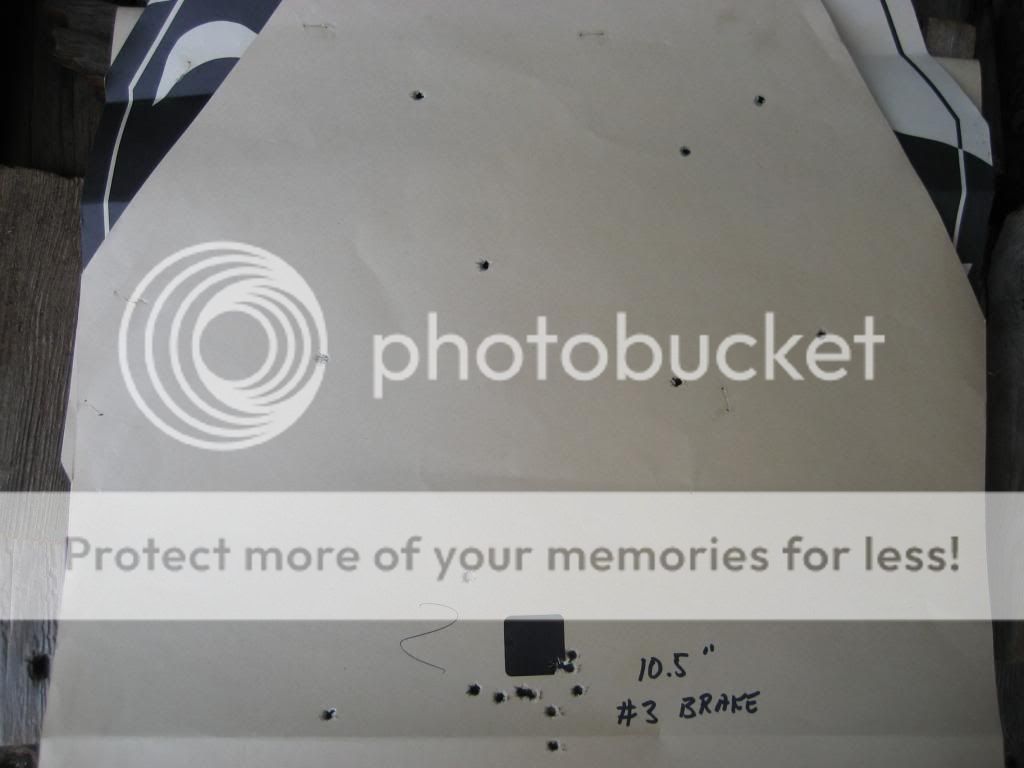

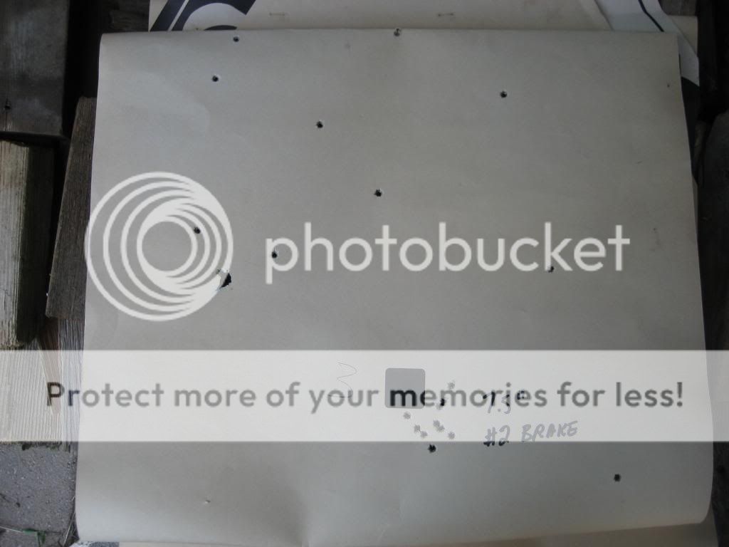

These two were poor:
I took the brake off the 10.5" rifle and installed brake #4. This is a large brake with large gills. The bark was incredible. It worked to control the second shot a bit.
