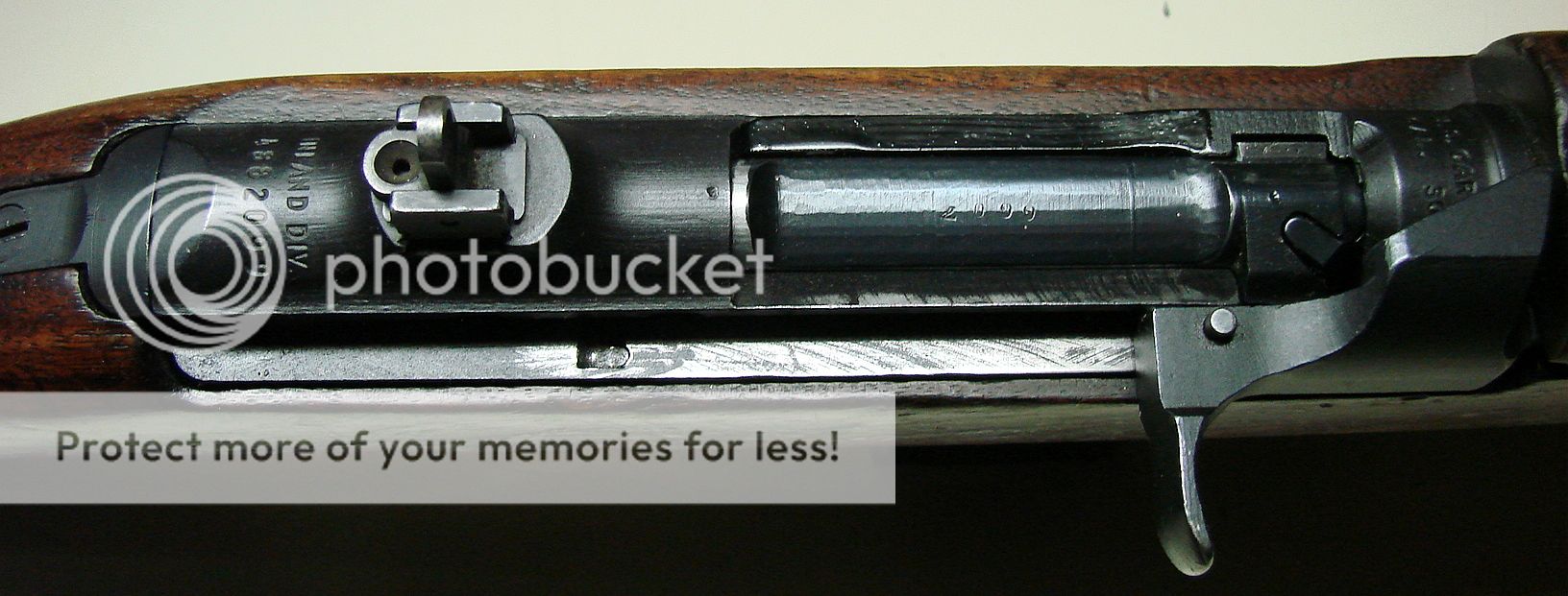

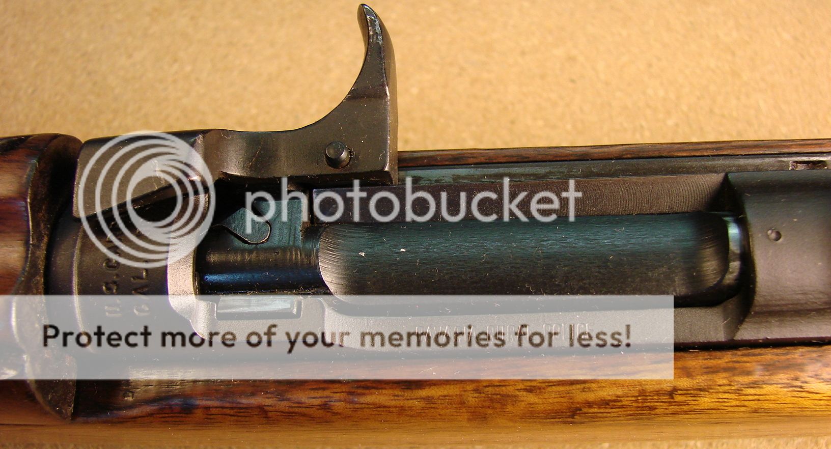

The ‘black goop’ is another oddity. So far I've only seen it on the carbines brought back by Century Arms in the 1970's. Amongst those, the quality of the removal varied greatly as did the substances they used to cover the machined area. Some was the goop, some was paint, some were what looked like a cold bluing touch up that was black.

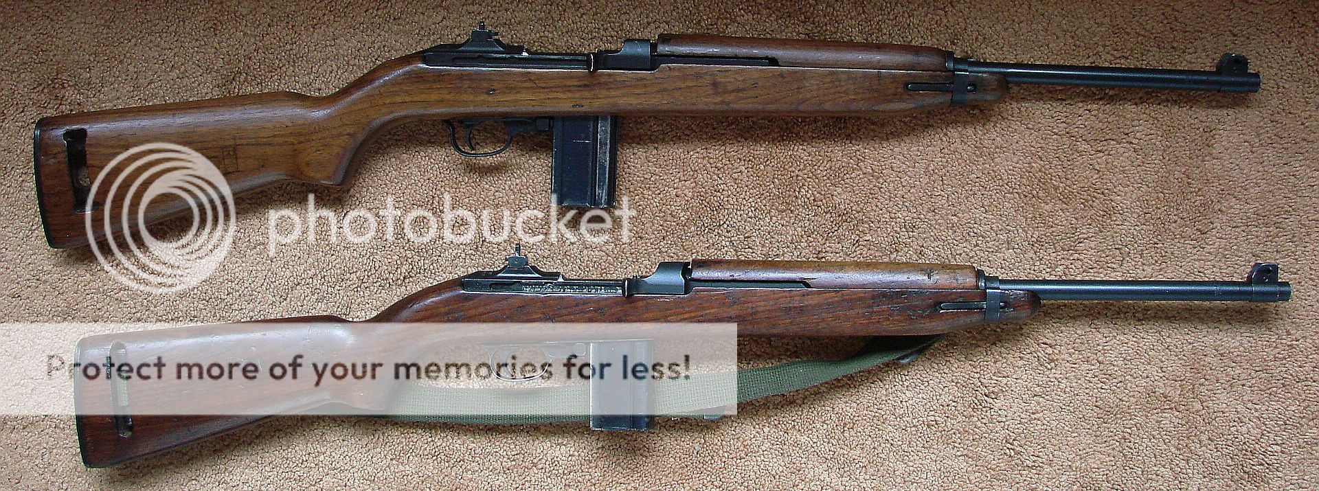

The black 'goop' on the left rail that covered the Bavaria Rural Police agency marking.
The carbine.

Don't think it's a Bavarian. Might be though. The best place for info on all Carbines is here. Send Jim the details of your's. Good guy. Add the W's. .bavarianm1carbines.com/bavaria.html
That is indeed a Bavarian. Unlike the other German police agencies that removed the rear sight, cut down the sight ramp and soldered a mauser style sight on the front of the receiver, the Bavarians left theirs as they got them. I have three, and one of mine is an early model like yours and with the exact same goopy sloppy agency removal. My other two still retain their markings. I always thought that mine was just a collector who wanted it 'USGI' in the days before the appreciation for the 'Bavarian' model became known.
David, how do you know its a Bavarian Rural Police and not one of the others? I have a Bavarian Rural Police, Bavarian Municipal Police and the 'Goopy'. All the Bavarians are generally marked the same, with the last 4 serial digits marked all over the place.

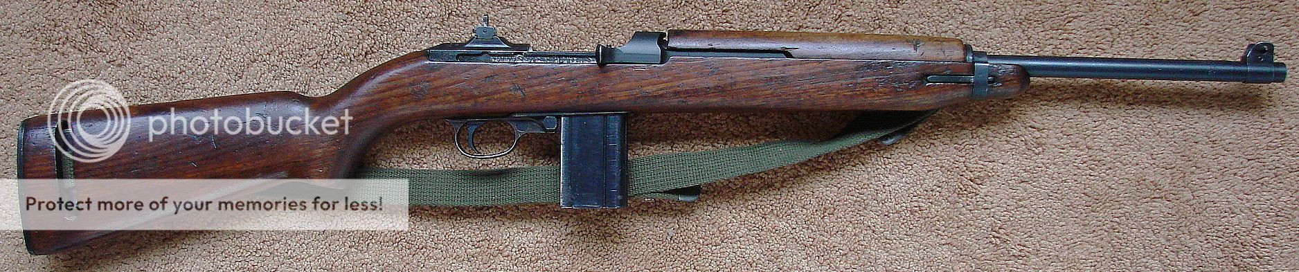

The Bavarian carbine shown above has been featured on Jim Mock's Bavaria Carbine web site since Jan 7th 2007 in the section Bavaria (agency name removed)
I purchased this carbine in December 2002 from a private non-dealer seller, he owned it since 1998.
http://www.bavarianm1carbines.com/carbineGBX_mills.html
http://www.bavarianm1carbines.com/armory.html#rural
My other Bavaria Rural Police carbine is also there in the Bavaria & Württemberg-Baden section.
http://www.bavarianm1carbines.com/carbineGWB_mills2.html
I purchased this carbine on January 3rd 2007 from the same seller as the carbine above, he also owned it since 1998.
It went on Jim Mock's web site on Jan 7th 2007.
