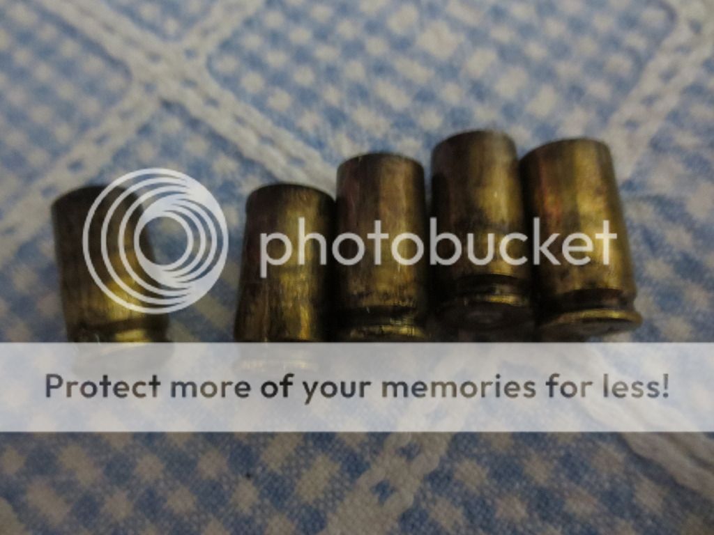

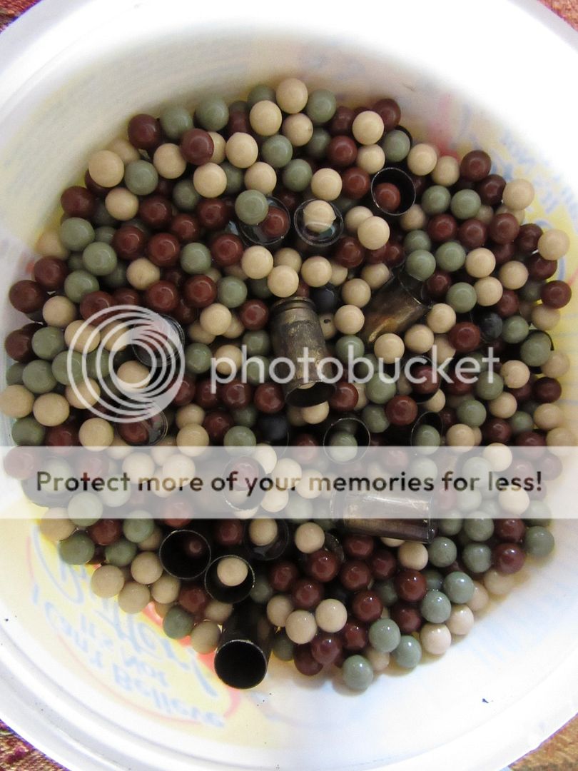

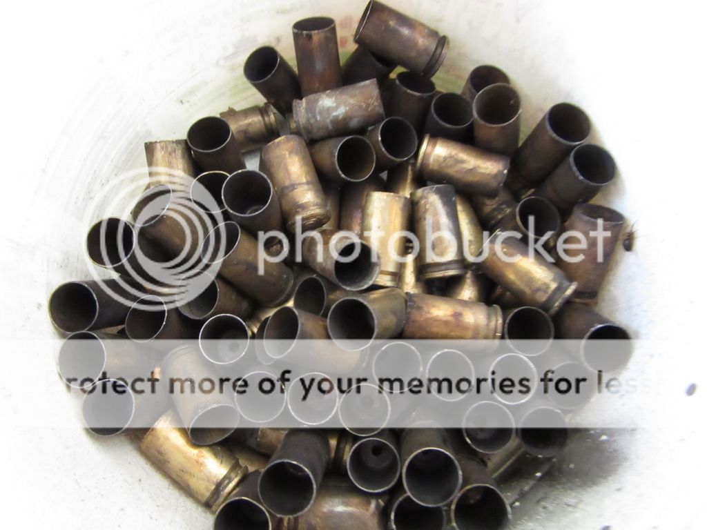

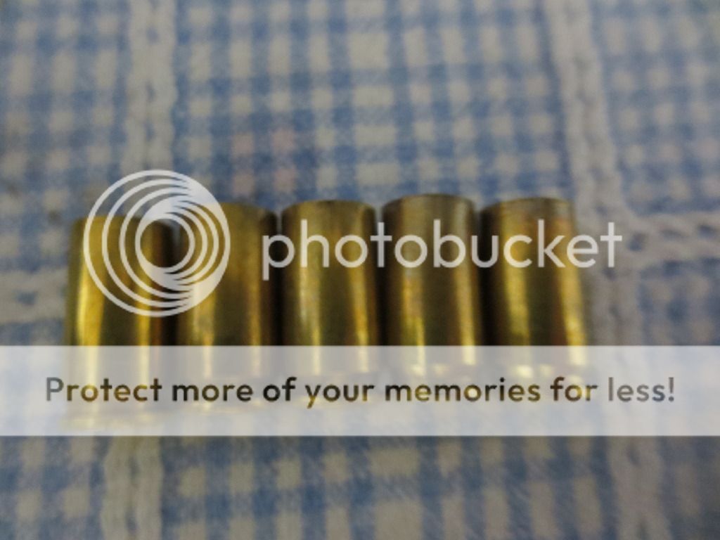

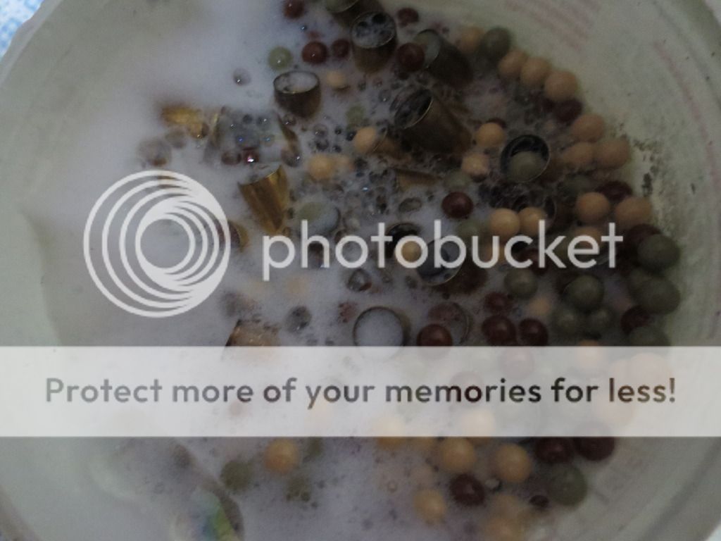

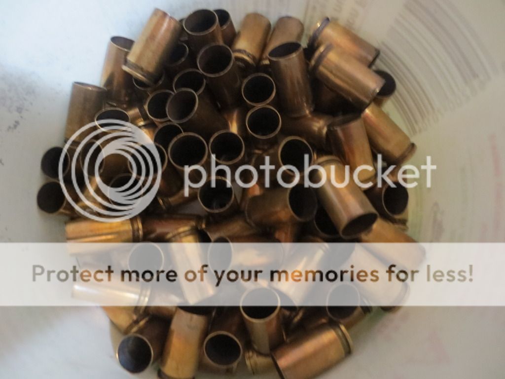

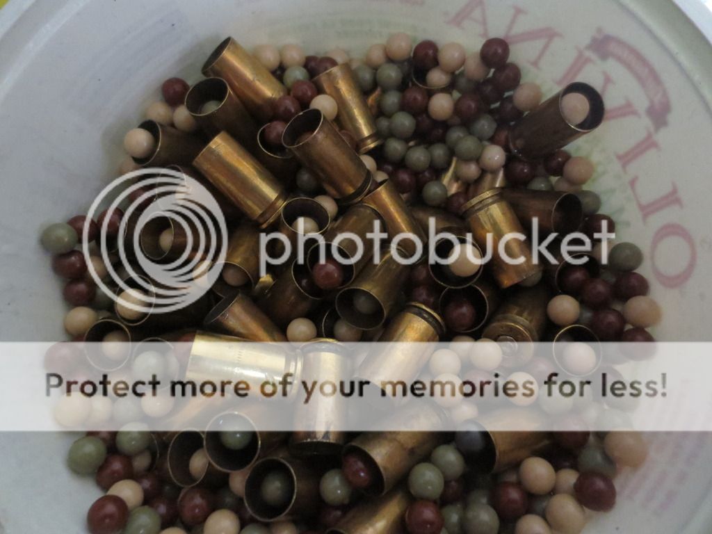

Hey guys. I had a bunch of dirty 9mm range brass that needed some tumbling, so I decided to make my own process for tumbling. I have a whole bunch of 6mm plastic airsoft BB's that I used as my tumbling media. So I got a margarine container and filled it half way with 9mm brass and airsoft BB's, and then added some dawn dish soap. Fill the margarine container all the way with hot tap water, then get the lid and close it. Shake it for about 1 minute, then open the lid a crack (just enough so the BB's don't spill out, but the water drains), all black crap from the shells will drain out. Fill it with hot water again, then repeat the process until there is no more soap suds left.
It won't remove the old stains on the brass, but it does a pretty good job getting the bulk gunk off the brass. I'm probably going to buy a tumbler, but I thought it would be a cool idea to share on here. The pictures below are in order from before they were cleaned to after.
