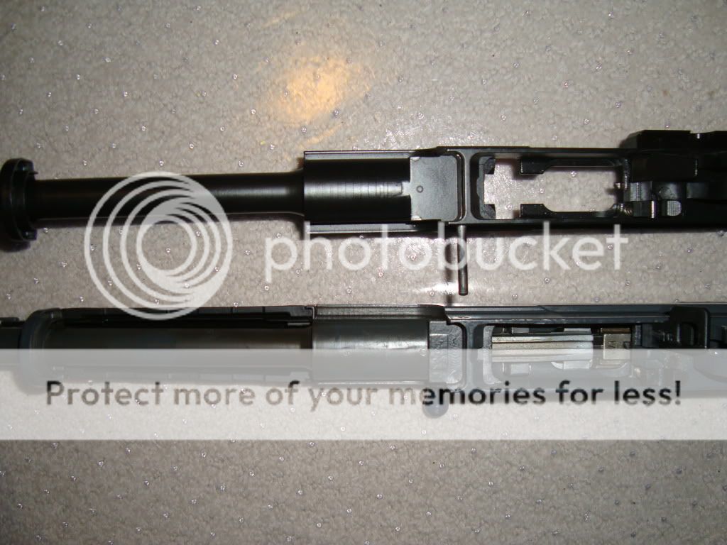

Has anyone tried these on one of the new SA VZ58 Sporter Carbines from Wolverine? I had planned on moving my Dlask rails, the ones sold by Infratek, over to the carbine, but the base of the barrel is different enough to prevent the lower rail from mounting.
The full length CZH 2003 that the rails came off is the bottom gun:
We tested our handguard set on this type of model at Reliable Gun and they worked just the same as on any other variant that we have tried them on. The only issue that might arise is the lower retaining pin not being up to spec. This has occurred on some of the older models, most likely from extended use. Although once we replaced it with the proper spec retaining pin any wiggle was completely removed.

Thanks for the reply. Sold! :D

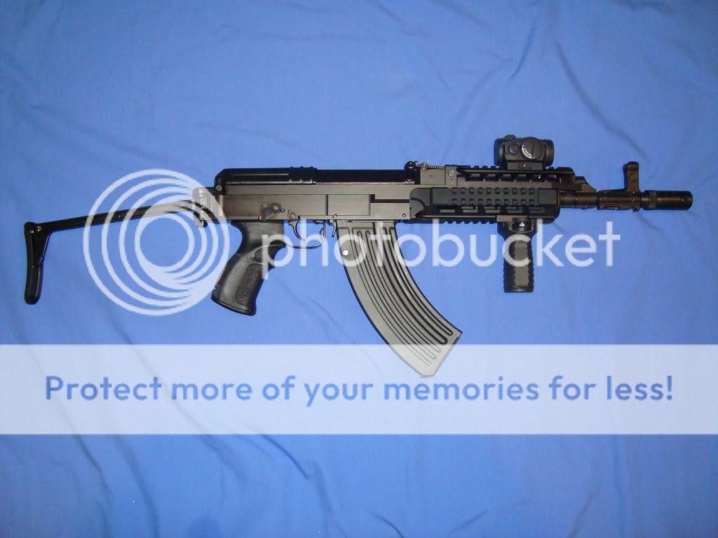

BC Tactical, as you said the handguards mounted easily.
Had the carbine on the range today and they worked great. Next visit I'll check the return to zero after removing then replacing the handguard with my Micro on it for cleaning.
