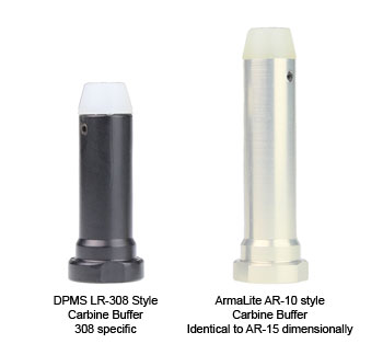

The buffer tube accepts AR15 carbine stocks, but it is about an inch longer than an AR15 carbine buffer tube so it isn't fully collapsed in the shortest position. However it is still about an inch shorter than an AR15 A1 style tube.
I think the spring is somewhere between carbine and A1 length as well.
The BCL 102 uses an A5 length buffer tube. (Longer than the AR15 Carbine tube)
The means you can use a standard H3 type AR15 buffer.
Now if you replace the buffer tube with a Carbine buffer tube (same as the AR15), you need to use the DPMS shorter ar308 buffer.
In the end these both allow for the longer length of travel needed for an AR in 308.
If you want to use a Rifle buffer tube (same as the ar15) then you need the AR10 specific rifle buffer.
