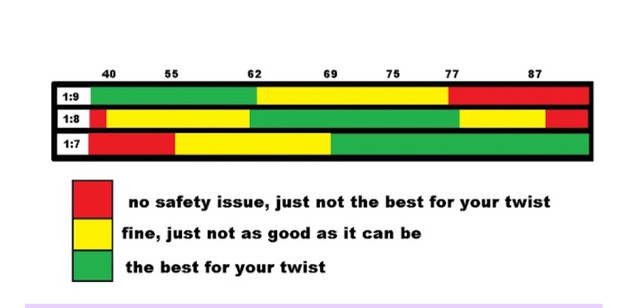

This twist chart from the NRA seems to indicate these Bison barrels would be better with a heavier projectile

And btw, take that graphic with a grain of salt - it is very generic at best and out to lunch at worst.
