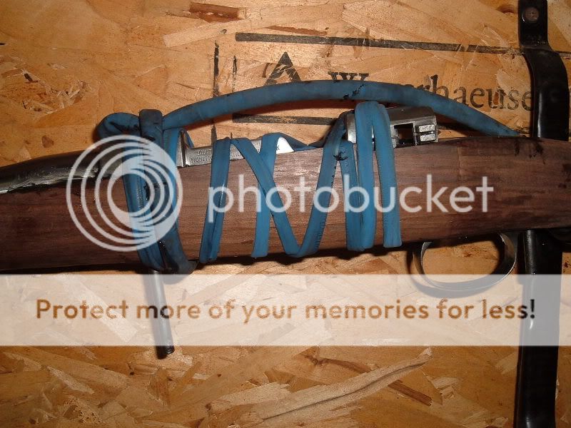

It's generally not a good idea to use the guard screws to pull the action into the wet bedding. If the inletting has high points in it, the action could end up twisted or stressed and accuracy could suffer. Use something that provides even clamping pressure.

Here's a shot of a rifle during bedding with my 'clamp' that provides even pressure on the action. The inletting screws are also visible.
