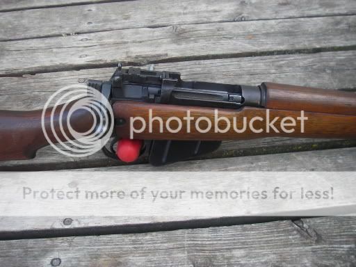

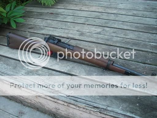

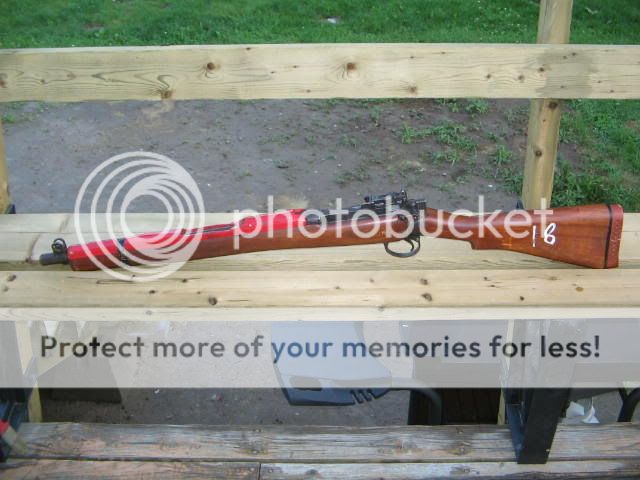

What it use to be
What it is now. No5 Mk1 ROF (F) Still need a flash hider and h/g ring to finish it off.
You are going to have to take the muzzle unit off to replace the rear handguard ring, so it might be easiest to wait and do both jobs at once.
Numrich sells the flash hiders and soft(er) recoil pads:
http://www.e-gunparts.com/DisplayAd.asp?chrProductSKU=254060&chrSuperSKU=&MC=
http://www.e-gunparts.com/DisplayAd.asp?chrProductSKU=502460&chrSuperSKU=&MC=
You're going to either have to have the first two inches of your barrel reduced in diameter by a lathe or do what I did on a similiar conversion and take your time using a dremel to do this. The No.5 flash hider has a smaller inside diameter than the standard outside diameter of your No.4 barrel - so therein lies the problem.
Nice work though. good luck :)

My bad - I should learn to read. I thought it was a bubba'd No.4...:p
It would be a bit of a pain, but if it had to be done, it would be possible to restore the original muzzle unit by lathe turning a new cone, welding it in place, and cleaning up the joint. I'd certainly want to remove the unit and not attempt the job with it still mounted on the rifle.
