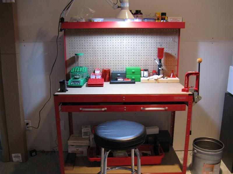

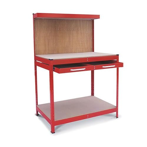

Sears has these benches on sale for $109.99 starting March 7th till April 12th. They may not be the ideal reloading bench for the basement, but I think it might do well for the price.

Also a beefier version with four drawers,a light and a power bar for $178.($?)
wots the height of the work top. I think the specs are giving the top height of the whole unit. 59 inches ??
Picked up the same one (minus the drawers) for $50 on sales at CTC. Replaced the top with 2 pieces of 3/4" MDF.

I have one of the CT bench's the blue one with the 2 drawers and light. Here's my problem... the metal that is around the main bench part is just basically and L shaped piece of sheet metal. It's very hard to drill and get the presses to sit on the edge of the bench. It's nearly impossible to get the front 2 holes fastened down on my lee pro 1000's and for my lyman rifle press with just the 2 spots to mount it, it sucks. As well, the particle board top will absorb moisture and swell around every hole you drill in it to mount the press plus it flex's like it's made of cardboard.
I am going to build a cheapie bench using 2x4 framing with a 3/8's thick steel top with a 3-4" overhang on the front to mount my press's.
I suppose if you can get a nice thick piece of plywood to replace the main part of the bench you might be OK but it's still a PITA to mount any press to the front edge of the bench.
Try having a 6"x8" 5/8" piece of steel cut and then have blind holes drilled and tapped so you can bolt it to the bench top from the bottom. Have similar holed drilled on the other side w/ your press bolt pattern. The other thing to remember when building your own bench- the move overhang youv'e got, the more tipping leverage your press has...
I have the cheap Canadian tire version with no drawers, I replaced the top with a thick enought piece of plywood. 3 Coats of Paint, Screwed into the metal and voila ! Oh and don't forget to fasten the bench to a wall to make it a little more stable. I didnt' have too much problems installing my redding press on this bench.
Yeah - what he said. The double thickness of MDF I put on mine is about 4" larger than the original in both length and width. I drilled holes through the sheet metal and fastened the top to the frame. My press is bolted through the MDF, not the metal frame and is plenty solid.
