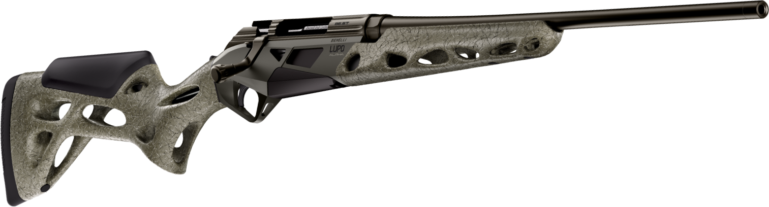

From a revolutionary engineering approach and the use of cutting-edge technologies a new species of bolt action rifle is born: ultralight, accurate, dominant.​
LUPO ALPHA​
Special edition of only 1,000 units in the .308 Winchester caliber.​
ULTRALIGHT​
  • ULTRALIGHT
    Lupo Alpha is the world's lightest metal-chassis rifle, weighing in at 2.6 kg, about 500 grams less than the standard version.
  • PIONEERING DESIGN
    The incredible lightness of the firearm is due to its particular design, with lightened metal components (receiver, upper receiver and barrel) and polymer components (stock and forearm).
  • CUTTING-EDGE MATERIALS
    The use of special high-strength technopolymers allows for a reduction in component weight without sacrificing stability and strength.
  • PENCIL PROFILE BARREL
    The barrel is tapered and with a lightened outer profile: the 26 mm diameter on the upper receiver side tapers down to 15.4 mm at the muzzle.
ACCURATE​
  • SUB-MOA PRECISION
    Lupo Alpha features an integrated system of solutions, which guarantee constant sub-MOA accuracy over 3 shots with high quality commercial ammunition.
  • STRUCTURAL SOLIDITY
    The perfect pairing of light aluminum alloy chassis and rigid steel barrel-action guarantees ballistic excellence with every shot.
  • CRIO FLOATING BARREL
    Cryogenic technology increases barrel life, improves thermal resistance, reduces the impact of overheating and regulates the vibratory stress of the metal, for consistent performance.
  • LIGHTER TRIGGER
    Adjustable from 650 gr to 1650 gr (from 6.4 N to 16.2 N), it is sharp and clean; the reduced trigger load maximizes shot accuracy.
EXPLORE​
  • INSPIRATION - Biomimetics
    The Lupo Alpha stock and forend design are inspired by biomimetics, a scientific approach that investigates how nature has found evolutionary solutions that respond to certain functionalities. In our case: how to combine lightness and strength? The natural system that inspired the Benelli team is the bone structure of some animal species, such as birds, which have internal cavities and a highly specialized skeleton that combines lightness and strength.
  • DESIGN - Generative Design
    Lupo Alpha's stock and forend were designed with an innovative method that "generates" potential designs based on performance objectives. The configurations produced are quickly explored with the use of artificial intelligence, until the most efficient solution is reached. In the final phase, the stock and forend design was remodeled by the Benelli team according to advanced ergonomic studies to optimize lightness, ergonomics and performance.
  • MANUFACTURING - Additive Manufacturing
    Lupo Alpha's stock and forend were made with an addition process. Unlike traditional production methods, which create objects by subtracting material, 3D printing or additive manufacturing is a modern production process in which objects are made by adding successive layers of material. This highly sustainable method reduces waste and allows the creation of any type of geometry with an optimized design.
TECHNICAL INFO​
  1. Adjustable L.O.P.: 350 mm as standard, with variation of +/- 10 mm (340 mm and 360 mm).
  2. Combtech Comb:Reduces impact and vibration on the cheek.
  3. Ambidextrous Safety: Ergonomic and fluid, it is easy to operate while remaining perfectly aligned on the target.
  4. Adjustable Lightweight Trigger: 650g to 1650g (6.4N to 16.2N).
  5. Integrated Trigger Guard
  6. Chassis Structure: High rigidity of the assembly and maximum precision.
  7. Three-lugs BE.S.T. Grooved Bolt: Fluid arming cycle and handle with 60° opening.
  8. Removable Double Stack Magazine: Precise loading, greater compactness and capacity (5 shots).
  9. Natural Grip: The porous finish and embossed texture improve grip.
  10. Matte BE.S.T. Dark-Grey: Anti-corrosion and wear treatment.
  11. BE.S.T. Dark-Grey and Crio Free Floating Barrel: Sub-M.O.A. accuracy on 3 shots.
