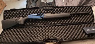

Benelli M2 SP or Beretta 1301 Comp Pro

Matches my Nova Speed. Obviously Im a Benelli fan but the 1301 comp pro is a fantastic gun and I will own one some day. The kicks stock and the pro lifter are very nice.
1301 is definitely the new hotness but even the comp pro will still need work to be at its full potential. Again, loading port.
