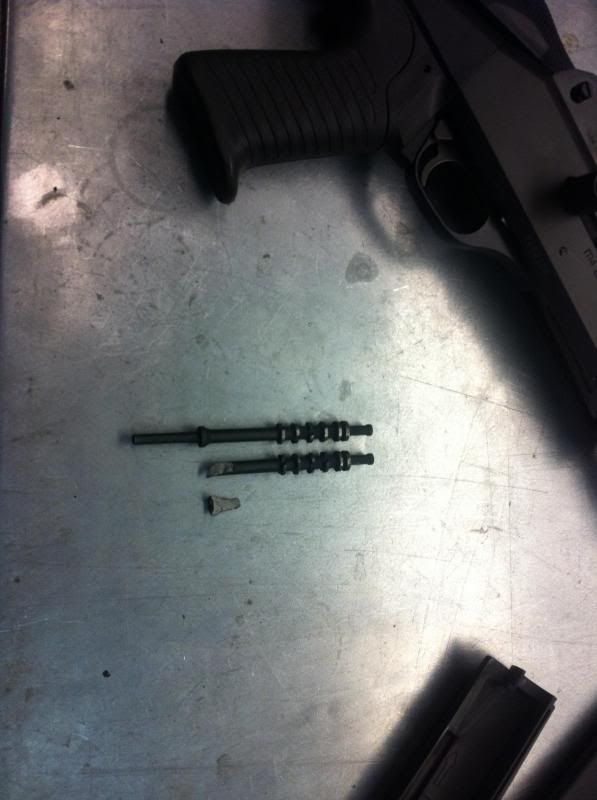

Benelli M4 broken gas piston
Anyone break theirs? I did this past weekend. I know I can get them from Brownells. Is there a place in Canada to get them Stoegers maybe?

Called Stoeger and have one coming was 90 bucks.
How did it break. Shooting 3 inch win bb loads all the sudden action jammed looked inside and one of the pistons had snapped off right where it stops on the barrel. Removed broken piece and tried using with one piston. Gun still performed for a few shots after and then I stopped. #### happens I guess.
That is unusual. But everything mechanical can fail, perhaps a heat treatment defect ?

I burnt out a piston in a Benelli R1 rifle. It took 15 boxes of HotShot brand ammo without cleaning it. The early ones were an alloy that would corrode under the piston rings. They have since update to a 2 piece piston and the part where the rings are is stainless.
You're failure looks corroded too, but probably just dirty as it doesn't look like an alloy part.
