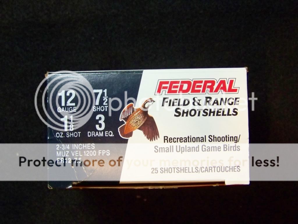

How does one determine what shells are 3 dram or better? I don't think I have ever seen it on packaging.
The top flap on a box I happened to have handy. Labelled as 12ga, 1 1/8 oz, #7.5 shot, 3 Dram Eq. I don't think I have seen a north american manufactured box of shotgun ammo that hasn't had the dram equivalent on it, but I don't shoot much shotgun anymore and could have missed them changing the labels.

I never knew what dram was until I heard it on this thread, I will take a look at my boxes.
