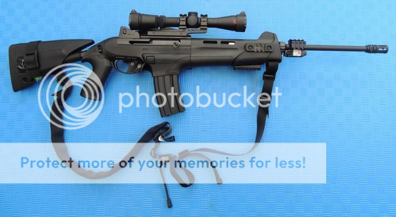

With the adjustable stock your cheekweld versus sight height depends on which position the stock is in.
I get a cheek/chin weld in the shorter positions that fit me and my scope setup. A definite cheekweld with the irons.
I have a stock pad for it but don't use it now. It gives me a good cheekweld with the scope but makes the irons hard to use and adds weight to the carbine.

If you don't mind me asking, where did you pick up the sling? I can't seem to find anything in the stores locally that looks like it will do the job. Also what else have you done modification wise? And where are you finding parts? I like the looks of it! (top one mostly)

I bought the 5.11 sling from site sponsor DS Tactical. I just put an old web loop I had in my parts drawer on the stock and attached the 2 point to it.
The 2x7 Redfield is in an NCStar knock off QD mount but it's worked fine so far. The scope is a Redfield 2x7 Accurange reticle and the holdover works fine to 200 yards. I need to find a longer range to stretch it out. With both eyes open at 2x the scope is fast to use at closer range.
Dlask shortened the barrel to 18.5" and threaded it 1/2" x 28. It has an A2 birdcage on it.
On the left I have a 960 lumen Fenix PD35 and on the right a cheap tape switch laser set up for 10-15 yards. I'm going to get a black infra red/visible laser for it when I source one.
