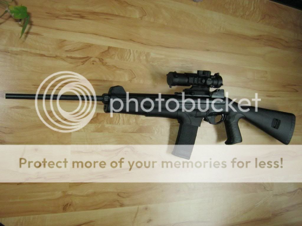

I put a Redfield 2x7 with an Accu range reticle on it in Leupold see-through rings (so that I can still use the irons).
I have since added a Blackhawk cheek rest and a Vickers 2 point sling.
I shoot it way more than my CQ-A and since it is non-restricted it goes with me whenever I head into the bush.

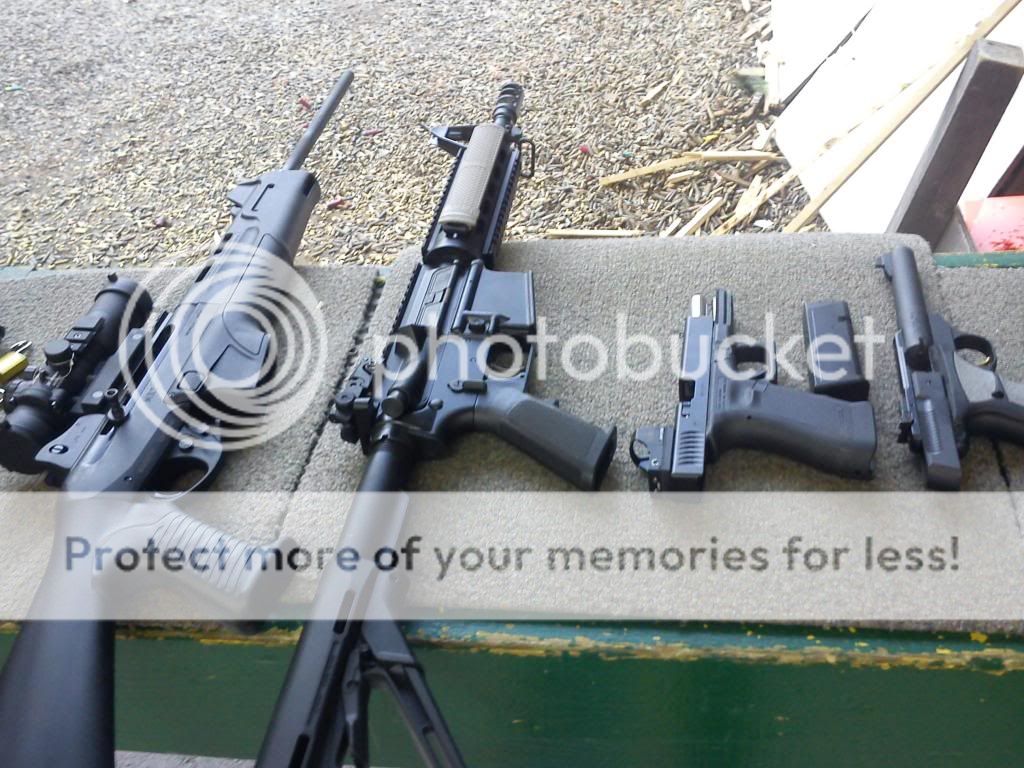

With Fiochi ball at 100 yards off a front rest (no sand bags) it groups 5 rounds into 2". With sand bags it would do better.
At 200 yards I got a 5 shot 3.5" group.
At 2x it's almost as fast as red dot.
I was able to shoot accurately with the irons through the see through rings.

I'm loving mine more every time I shoot it - even after a year or so! I do like the stock sights, but I put a burris ar-332 3x red dot on mine. it's balanced really well and I do like the ambi bolt release infront of the trigger guard. my mr1 is not as reliable with lar15 mags, but never have a problem with pmags.
