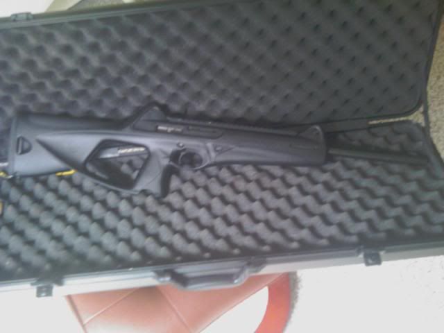

here is how it looks like, nothing special from outside, just another Beretta Storm

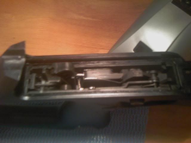

view of lower with magazine inserted

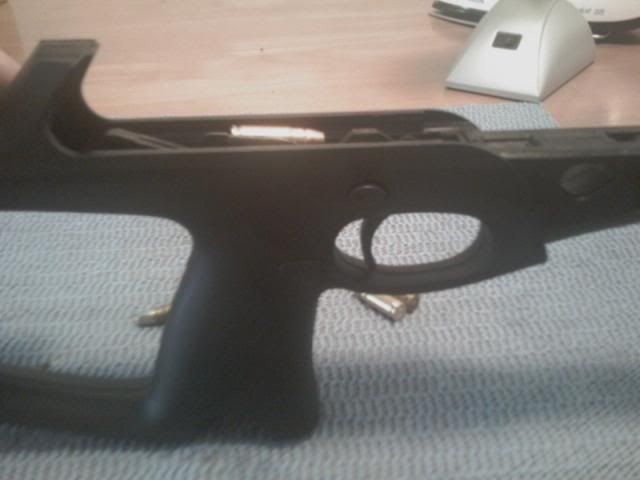

same view with ammo in a magazine (factory surplus ball ammo)

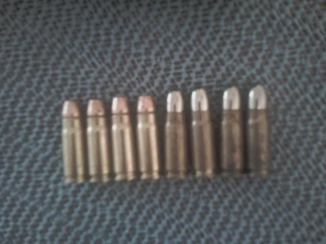

picture of surplus ammo beside my own roll of 85gr over 14.5gr of H110.

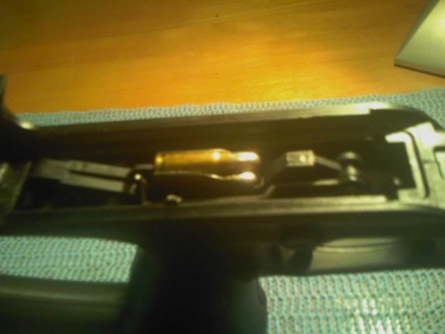

Test firing went ok, no problems whatsoever except for a slight feeding issue. Tokarev grip angle is diferent and therefore ammo is sitting with slight nose down angle and does get caught on a shoulder of bottleneck chamber. You can see it on this picture
I am thinking about adopting some double-stack magazine made for 38 super with rake angle close to beretta's. If anyone can make a suggestion it will be highly appreciated.

without any regards to make - what off-the-shelf double-stack pistol magazine may hold 7.62x25 round? I load them with light bullets seated to 1.28" OAL, should fit into 38 Super magazine, I just need the one that has similar rake angle. Suggestions please.

Probably the best bet for a double stack .38 super mag that's not too wide to fit the mag well would be a Caspian.
