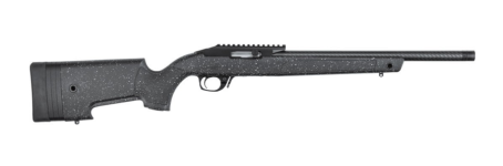

Which would be your pick between those 2 and why?

details claim it is a 'delayed blow-back action' but is it any different than being just a 10/22 clone?
Definitely no 'delayed blow back'. It's just a 10/22 clone. Everything except the trigger group is compatible. The trigger group can be swapped out for a 10/22 one but you can't put a 10/22 trigger kit in the BXR housing.

I have a Bergara bxr steel barrel.Was very frustrating at first,very unreliable with most ammo other than cci sv (and then not 100%).
The chamber had a razor sharp edge to it and would catch the lead on feeding rounds.I put a small,polished chamfer on the chamber mouth which has helped a lot.
The gun was very prone to light strikes out the box,50% with Aquila,less so with others.The hammer spring is notoriously light on these(it’s like a mini AR 15 style setup,so not really amenable to replacing with a heavier Ruger spring).I ended switching the whole trigger group to a Ruger group. 100% reliable now with a better trigger pull.
Bergara mag is terrible,use only Ruger mags now.
Had problem with mags sticking in the rifle,needed 3 hands to pull them out.Carefully Dremelled in the stock at high points,solved the problem.
I really enjoy the rifle now,it’s very accurate and I like the looks of it.Stock works well for me.As noted above,it does have a tight chamber and needs frequent bore snaking to keep it running.
As regards the original question,I do have a Ruger custom shop 10/22 and it has been a fantastic rifle.Very reliable and very accurate out the box.I have had other 10/22s in the past and they have been less problematic than the Bergara.
If I had to choose Ruger vs Bergara again,would go for the Ruger
Between the 2 I'd choose the Bergara, just don't like the stock on the 10/22. I looked for a Bergara with the barrel wrap 2 or 3 years ago but only the steel was available at that time. Ended up getting a 64 TR-SR. Not the fancy barrel wrap, but it does have a boyd's stock though. I wish it had a rotary mag but the 20 round butler creek mags cycle fine. Also changed out the trigger spring. About half the price of the BXR to and I doubt one shoots any better than the other.
I presently have the BXR and in the past I've had a couple of 10/22's.
I think the 10/22 is a bit more reliable in general but the stock on the BXR is really nice and so is the rail.
The Bergara seems to be temperamental in feeding than the 10/22's. At 200 to 300 rounds I see the odd fail to feed and by the time I get to 600 rounds it's happening pretty regularly so cleaning every 400 rounds or so is mandatory for best performance and reliability. I don't remember my 10/22's being like this. The Bergara barrels are good and the chambers are cut to tighter tolerances than the Ruger barrels so that contributes to feed issues.
