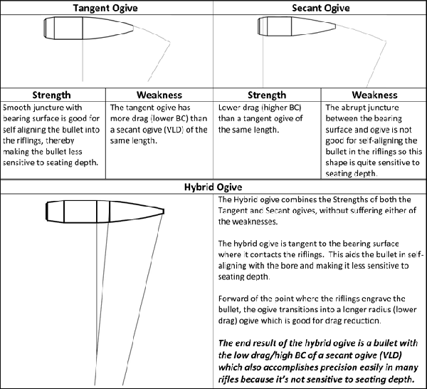

Pardon my stupidity but...... what is a "hybrid" bullet?
Practical Considerations — Load Length and Twist Rate
The superior ballistic performance of the 300gr Hybrid .338 is primarily due to the very long ogive and boat tail. However, that super-long bullet length can create some issues. Berger’s new .338 Hybrid bullets are so long that loaded rounds may not fit some magazines comfortably, unless you deep-seat the bullets, which cuts down on usable case capacity. If your loaded rounds with the new .338s are too long for your magazine, single-feeding is recommended. In addition, and this is IMPORTANT, to get optimal performance with the new bullets, you may want to extend the throat in your chamber. This can be done relatively easily by a competent gunsmith using a throating reamer. We caution, however, once the throat is pushed out, you can’t go back to a shorter throat without setting back the entire barrel.
The new .338 Hybrid bullets should stabilize well with a 1:10″ twist at the velocities achievable with popular .338 magnum cartridges. However, according to Bryan Litz, Berger’s Ballistician, at extreme long ranges (beyond one mile), as the .388 bullet goes trans-sonic, it may need more spin. As the bullet slows down into the trans-sonic range, extra stability is required — something you get by spinning the bullet faster. So, for those guys planning to shoot at one mile or beyond, Berger recommends a faster twist-rate. The faster twist provides more spin-stabilization at very long ranges. But for 1000-yard shooting, you don’t need to be concerned about trans-sonic stability. As Bryan explains: “So as long as you keep your shots under 1 mile, the 1:10″ twist is plenty adequate.”
"As the bullet slows down into the trans-sonic range, extra stability is required — something you get by spinning the bullet faster. So, for those guys planning to shoot at one mile or beyond, Berger recommends a faster twist-rate. The faster twist provides more spin-stabilization at very long ranges. "
This is the part I don't understand. As a bullet slows down, the effect of spin stabilization GOES UP - rotational inertia degrades slower then velocity. As is also described by Bryan in his book.
Sooooo, what's up?

Stability increases as the bullet slows down UNTIL the bullet slows to transonic speeds. As the bullet slows down from the muzzle to ~1200 fps stability increases because the ratio of spin to forward velocity is increasing and the aerodynamic overturning torque is diminishing with it. However as the bullet slows to transonic speeds, the aerodynamic coefficients (and torques) related to bullet stability go thru some abrupt changes and overwhelm the trend of increasing stability. Some bullets are able to negotiate transonic speeds without loosing stability, others aren't. It's very difficult to predict. In general, the longer bullets have more trouble than the shorter bullets but it's something you have to try to know for sure.
The large meplats on the 6mm 105's came about for a different reason than the large meplas on the new 7mm's. The new 7mm's were given larger meplat in an effort to combat OAL and meplat diameter variations which cause inconsistencies in BC. The larger meplats have about 30% less variation than the original 180 VLD's, so from that point of view they're a success. The best solution would be to make the small meplat's more consistent but this is very challenging long term project. The new 7mm's are able to achieve lower drag than the originals despite their wider tips because of other design features. The new 7mm's have longer BT's at 7 degrees instead of 9. They also have longer noses, all of which act to lower the drag. The wider tip is the only part of the bullet that's higher drag, and it's not enough to dominate the overall drag. Because the meplat is larger, these bullets benefit more than average from pointing the tips. A 2 to 4% increase in BC is typical for pointing 'small tip' bullets. However these 'large tip' bullets benefit by 8% (this has been directly measured).
The hybrid ogives appear to be achieving their goals of combining the strengths of tangent and VLD ogives (low drag and insensitivity to seating depth). So far they've only been made in 7mm and .338. The hybrid concept is growing to other calibers; 6mm and .30 cal next, then 6.5mm. It will be a long time before hybrids are available in these other calibers so I won't share anymore info on them at this time other than to say we're embracing the hybrid concept.
