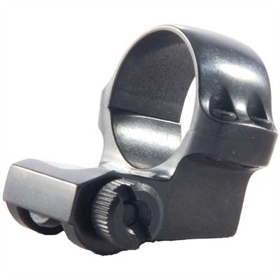

Yes, you may have to go with either a single or double offset ring. You can look them up here, by entering your model numbers.
Shop Ruger
Will look something like this:
