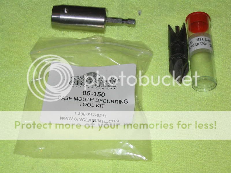

Aaaand by far, I don't think it's close in the price range.

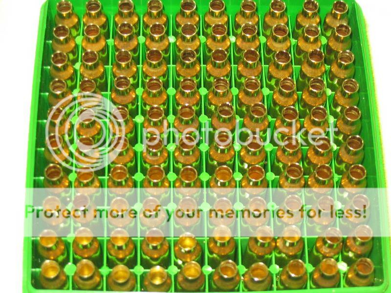

I'd trimmed 500 new .204 brass and am working on a similar number of .223. I dread deburring and chamfering by hand. Doing both operations at a nice steady pace on 100 brass, including a smoke break, took me just over 1/2 hour. Would have taken me hours doing 20 at a time by hand, there were some pretty big ridges of brass to take off due to the trimming of up to 6-7 thou from some of the cases and using the wrong cutter head on my trimmer :redface:
The rig cost me $21.25. I had a total order of $73 that cost $8 to ship, so add a couple of bucks into the cost of the tool, I'm still under $25 and happier than a pig in :wave: Shipping was reasonably quick for USPS ground - had my stuff today after ordering on the 14th, so basically 2 weeks.

Just got my Sinclair chamfer tool kit in the mail today. (Same one Redhouse got) Of course they got here the very next day after I finished chamfering 250 .223 cases with that little Lee thimble chamfer tool. :mad:
But I tested it on a .44 magnum case...Tool in my drill and hand held the case...MAN!!!! Sweet tool!!! And razor sharp too. Its gonna definately be easier to do the next big chamfer job. :D
Nope, just shave it a tad till the sharp edge (the burr) left over from the trimmer is removed. both inside and out. Don't take too much off or you'll end up shortening the case even more.
I found that I was able to do the whole block of cases without removing them from the block - just by putting a finger against the side of the case to keep it from spinning while chamfering. The trouble is if you do stuff too fast, then you stop playing sooner and go back to real life. These little repetitive things are a little therapeutic - I think.
