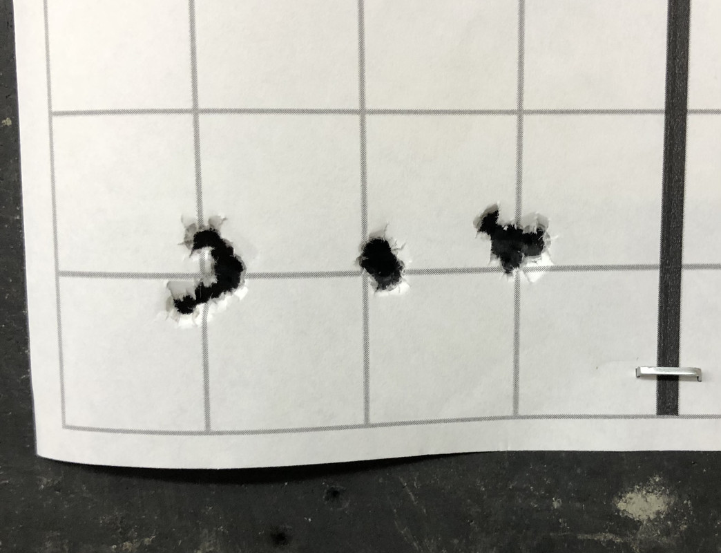

In my CZ457 it’s ok, but closing the bolt on them in the tight match chamber isn’t ideal. Once you develop a good shooting technique, then try out some other brands if you want better accuracy. The target should make it clear what your rifle likes.
The first and last 5-shot groups are CCI SV. The middle is Eley subsonic. This is what I mean about the target making it clear what your rifle likes.

Those are some pretty nasty groups damn. Yeah trial and error is the logical way to find the best ammo but I'm not there yet. Thanks for the info!
