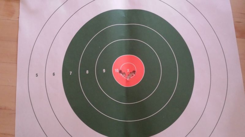

And I gave him an option, that will be more accurate then the Tikka, and half the price.
I'm not even a very good shot, but I can do this all day at 100m with irons on any of my S&L M69's. If me eyes were better and I had a 300m range I'd probably get better results.
That's more like it. Now you posted what he can expect from that rifle.

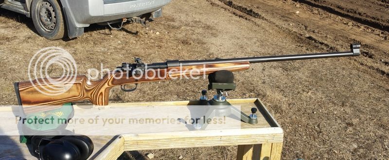

This. I scoped one of these for a buddy about twenty years ago, a very good shooting rifle. - dan
I have one I'll probably get a rail put on, bent bolt, in the next few weeks. I want to try it with irons at 700m first for fun. Just looking to hit a 12" gong at that distance and I'll be happy. The Boyds stock isn't really geared for irons anyway, pretty high comb. No shortage of aftermarket stuff for a '98.
